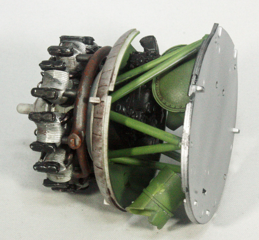

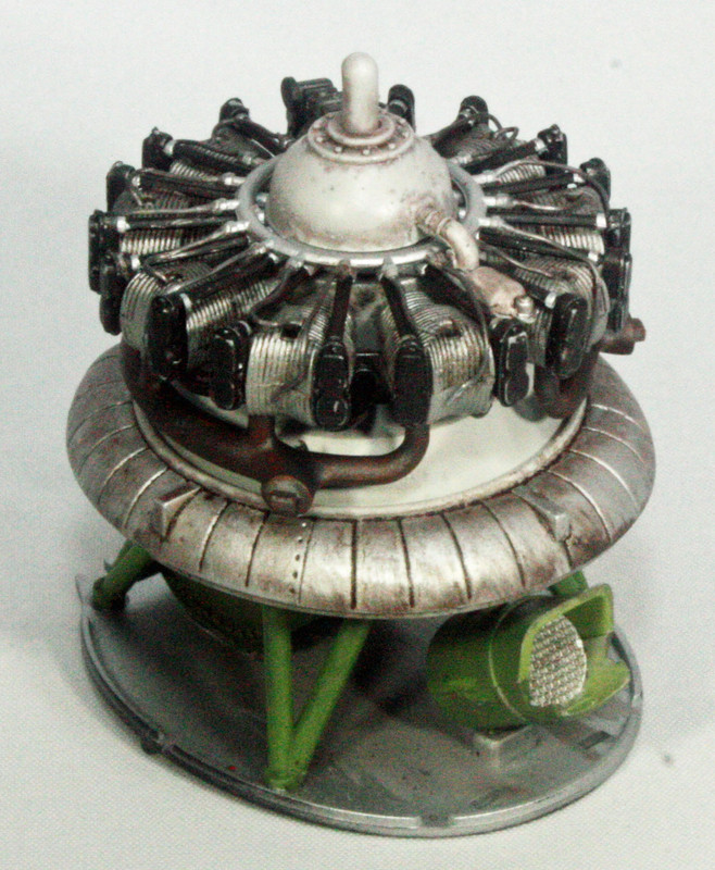

I started construction with the engine.  I added .4mm lead wire for the ignition wires.  I could not find anything definitive as to where the second wire in each tandem actually connected, so I wrapped it around to the backside.  Midway Dauntless dive bombers tended to be the new SBD-3 models (the Navy began phasing out the SBD-2 following the Battle of the Coral Sea), so I figure the weathering should not be too obvious, but for the engine, I applied a bit of AK Interactive Streaking Grime followed by feathering with white spirit.

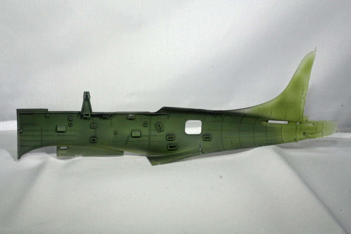

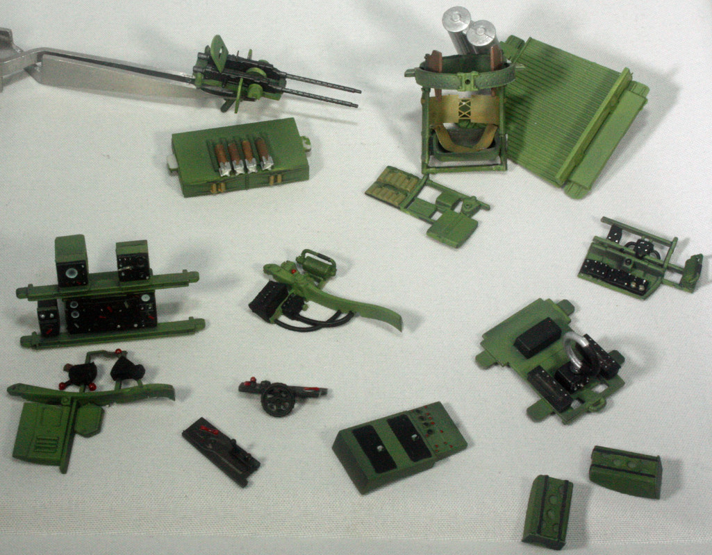

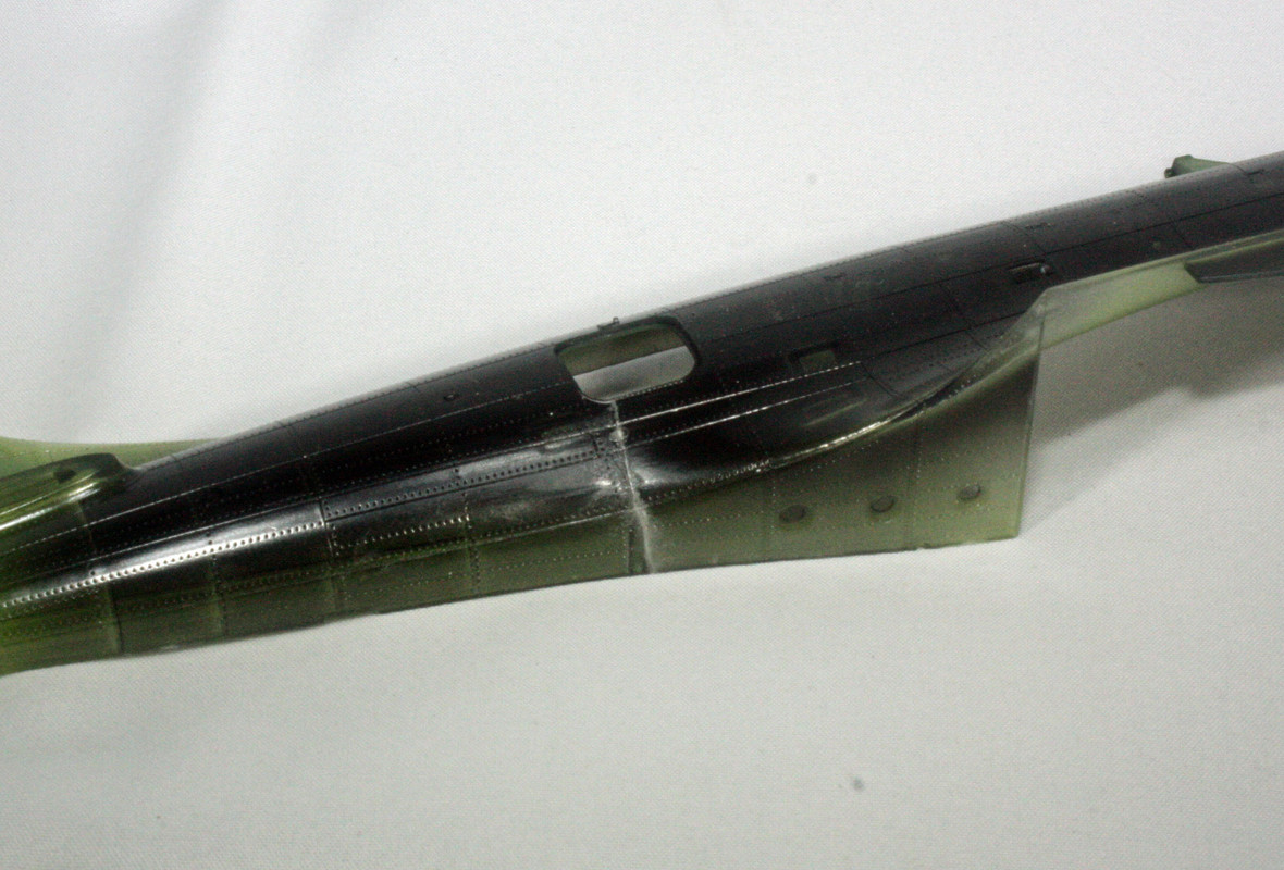

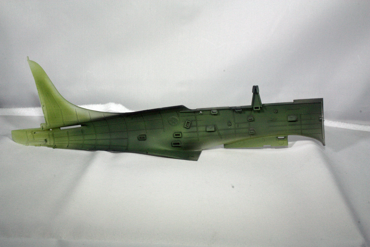

This is the clear edition, but I was never going to build it as such.  I also wanted to try a different approach with painting the interior, so I first put down a coat of black Stynylrez primer on the interior surfaces of the fuselage and all the interior parts.  Then painted with Mission Models Green Zinc Chromate.  I think the primer base has allowed for the GZC to be a bit darker than it is coming out of the bottle.

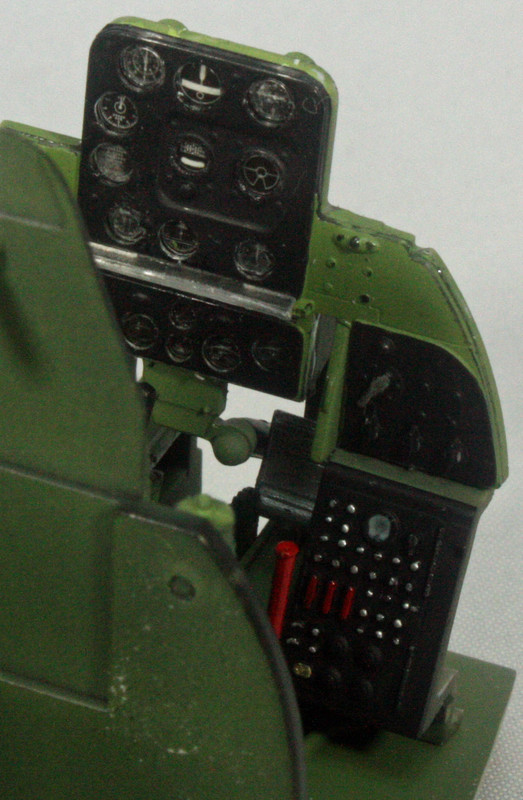

When I install all the cockpit parts into the fuselage, I plan to add some thick lead wire (not sure what size just yet) to replicate the tubes coming out of the O2 tanks, and run some electrical wiring throughout the cockpit.  Very little of that detailing will actually be visible once I close up the fuselage, but it's always fun to build to this leve of (insanity) detailing.
Finally, clear plastic is a bit more brittle than gray plastic.  I noted before I started painting that the fuselage part was split from the bottom of the access hatch located behind the tail gunner on the starboard side.  I glued the plastic together, but I may have to do some sanding to eliminate the evidence of the split.

Looks great, Stephen.  I have that same kit and have been wondering about the brittleness of the clear fuselage.

I bought the kit from someone on eBay, but it did come with everything still on the sprues.  There was also some foam packing in the box, so I can't figure what happened to cause that crack in the fuselage.

Outstanding work, particularly the engine.

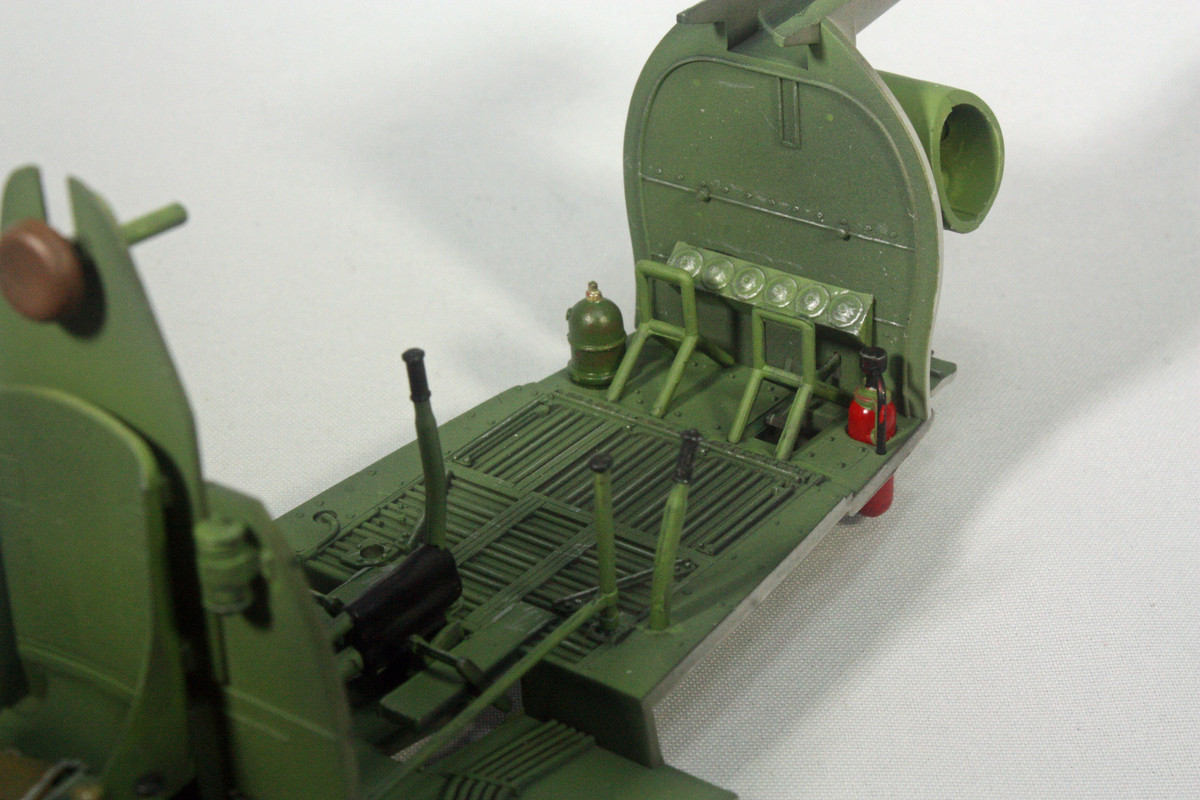

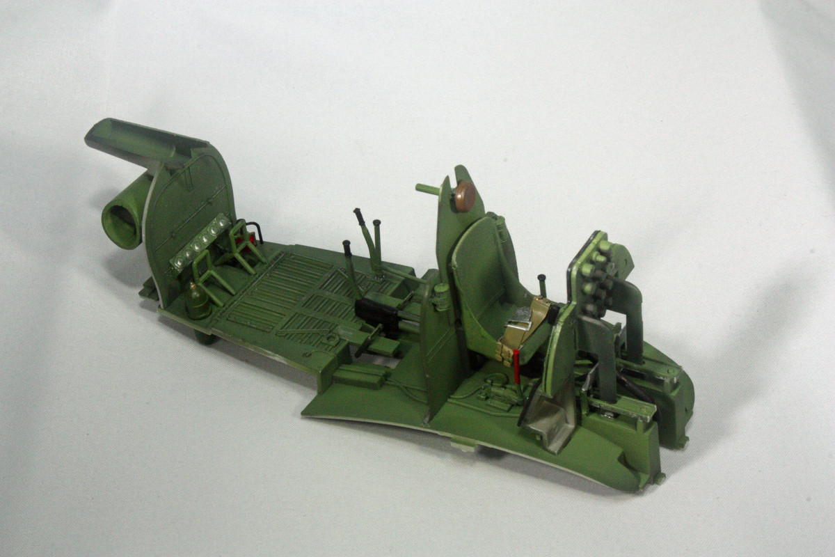

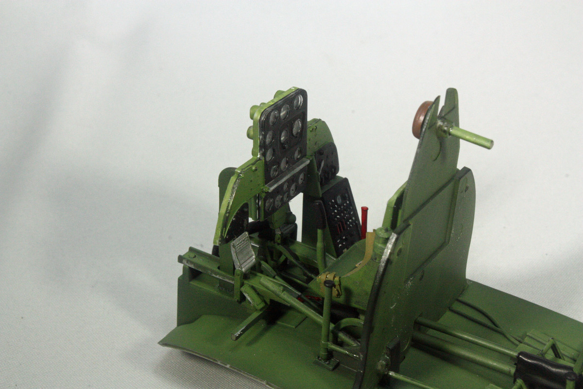

Today was a productive day at the bench.  I managed to get all the cockpit components installed into the fuselage, and button up the fuselage.  I added .4mm lead wire for some electrical components inside, and .8mm lead wire to replicate the O2 hoses for both the pilot and the gunner.  Some light weathering with Flory dark dirt wash.
I ran into a couple of problems.  First, there are two tanks located right behind both shoulders of the pilot; while fitting the fuselage halves together, I saw something fall out, which I was able to identify as one of those tanks.  It is still missing somewhere on the floor of my work room.  Hope to be able to locate it as it will be pretty obvious that it is missing once I'm done with this build.  Also knocked off the head rest when removing clamps - that part fell into my sleeve, so I was able to find that one easily enough.
The other problem was one related to the kit's manufacture.  On either side of the forward cockpit, there are panels.  On one side is a trim wheel (?) and the other a couple of levers.  The panels were too long, resulting in no space to install the main cockpit panel with the pilot's seat bulk head.  I dry-fitted these parts several times, but always with the same result.  So out came the snippers, and I trimmed the panel parts to a length sufficient to allow for proper installation of the bulk head.
