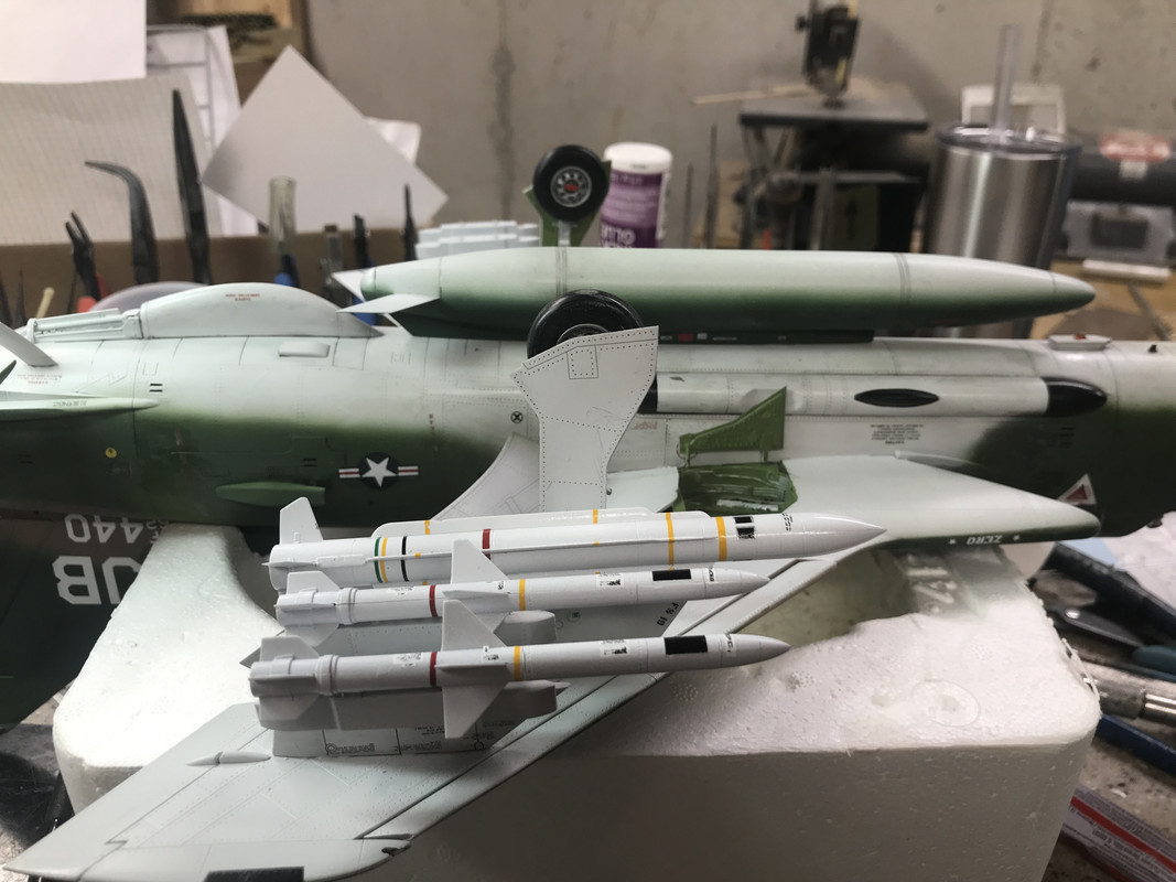

Finally today was the first painting day. I mixed up a very light, light gray using gloss Tamiya White and just a taste of Nato Black plus some Iso Alcohol and a few drops of retarder. I put the first coat on the gear doors after affixing them with some masking tape loops, and was going to paint the nose gear doors when I saw that a) I hadn't painted their insides with interior green and b) there were huge ejection pin marks that I really couldn't ignore since these WILL BE SEEN. So I stopped painting and filled the divots. Some were proud of the surface and needed to be chiseled off and others were indentations requiring filling. Early Trumpeter is nortorious for this.
I then stuck them to some tape along with the others and painted them all.
I paint their interior green parts after all the white work is done.
I drilled the missiles on their mating surfaces to accept some green florists wire. The wire is 0.046" and the drill was 0.0455 so it was a very nice push fit. I then attached all the wires to the rotary painting stand in prep for their painting which would be straight gloss white. I won't need to fill these holes since they're hidden by the mounting racks.
I didn't paint them until all the off-white bottom paint was done.
I started painting the model's bottom. It took several passes to get a nice coverage. Using gloss white as a base means I don't have to gloss it before decaling. That saves a step and reduces another chance for error. That dark spot at the foreground wing root is a reflection. The paint went on flawlessly. I'm letting dry thoroughly overnight so it's going to be easy to handle.
I also painted the bottom of the centerline tank since it's bottom color, not pure white.
The instructions show this tank as all white, but I've seen pictures that show it a two-tone affair with the dark green camo color on the top half with a soft edge.
I then painted the missiles their pure white. This is also gloss so it will faciliate decaling. There are lots of decals on the missiles and the their supports. Having glued on the pylons will not make decaling easier.

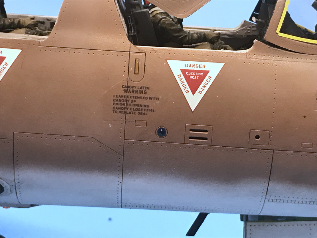

Then I decided to get really frisky. I wanted to try and use Tamiya Panel Accent Color and bring out the panels and fasteners on the bottom (and the rest of the plane).
I again watched some videos on using this product since I'm not quite sure when to remove the excess. Apparently, you should wait until it dries, then go back and with a very lightly moistened Q-tip with some low-odor mineral spirits. After that you clean the residue with a clean Q-tip.
On the first side I added the accent to the panel lines AND all the fasteners, but it created a lot of product to remove. On the other side, I just added it to the seam lines. I think that may be better. In either case, there is some residue left behind that adds some character to the bottom. It's no longer prisitine.
This was the side with the fastener coloring.
Here's is the entire bottom done. I went back and cleaned up the dirty area behind the front landing gear after I took this picture. These planes were rode hard and put away wet so a little grunge probably is okay.
I brought the panel painting up around the plane and it's looking decent.
I find the success is simply based on the depth of the engraving done by Trumpeter. The vertical seams are engraved more sharply than the horizontal ones. When I do the wipe down, the horizontal lines tend to lose the accent.

Did some errands and then got to work. Bought some nice new backdrop paper (actually bulletin board paper from Michael's) and other stuff. Finished decaling all the missiles and the centerline tank, and went back and cleaned up the panel line work a bit more, and lined the vertical stab which I didn't do yesterday.
All the missiles are ready to put onto the aircraft. I used MicroSol and MicroSet. I never know which one does what so I end up using both.
I then did the same for the centerline tank. Thankfully, all those tags were actually just one decal.
Lastly, I went back and did the rudder. As you can see, I'm finally figuring out how to do it without adding too much material making it harder to remove. I also found that the longer it dries, the better the clean up is since the material actually in the grooves tends to stay there a bit longer. I also reduced the amount of solvent on the Q-tips to the barest minimum. The lines on the tank were put down yesterday, but I cleaned them up today and most of the material in the grooves stayed put.
You really want to put the tiniest amount of accent into the groove that you can just to get it flow. You watch the flow and don't add any more until it actually stops so you're not adding too much excess. The upper part of the tail on this particular plane appears to be bare metal, and there are antenna on the tail and wing tips that need to be masked and painted black.

I then got back to applying the starboard side decals. All went splendidly, until when I was grasping the fuselage to lift it and place a decal that was near the fore bottom, and the "stars and bars" on the fuze side transfered itself to my thumb. Then in my attempt to peel it off and put it back, it started to fracture. This is the result.
I may be able to clean it up a bit more with some strategic touch-up painting, but it won't be pristine. Why do decals have more affinity for flesh than models?
The shark decal on this side was having trouble getting around the compound curves of the nose. I had to slice the decal in two places so it settled in. That was after copious amounts of MicroSol. There's still a spot that has a wrinkle on the edge that I'll have to slice I'm afraid.
I was surprised that the "emergency release" decals were missing for the starboard side under the cockpit. The "Ejection Seat" triangles were included. I may just highlight the yellow lever in the at engraved portion to match the other side, but won't be able to duplicate the text. I may be able to make my own... now that I think about it. I just took some closeups of that graphic and will make my own. Once again, writing this journal gets me thinking.
This was the closeup that I took to get the text. I actually created new text over the decal text since it wasn't very precise. I don't like how that triangle decal is not settled in on top.
Here's what the decal's supposed to look like after I print it.
Now I'm going to go upstairs and print it.
And now that I think about it. I have one more stars and bars for the wing bottom that's intact. I may be able to scan that and reproduce a couple of good ones on white decal film. I'm going to give that a try too.
The making of the Stars and Bars worked well too. I scanned the decal, and then re-drew it over the image since I wanted a very clean edge without any pixelation. The results of both activities were good. The "ejection warning" could be printed on clear film since there was no white on it. The "stars and bars" required printing on white decal inkjet paper.
Here's the decals after I sprayed them with Testor's decal film spray. Inkjet ink is water soluble so you must seal it before soaking in water.

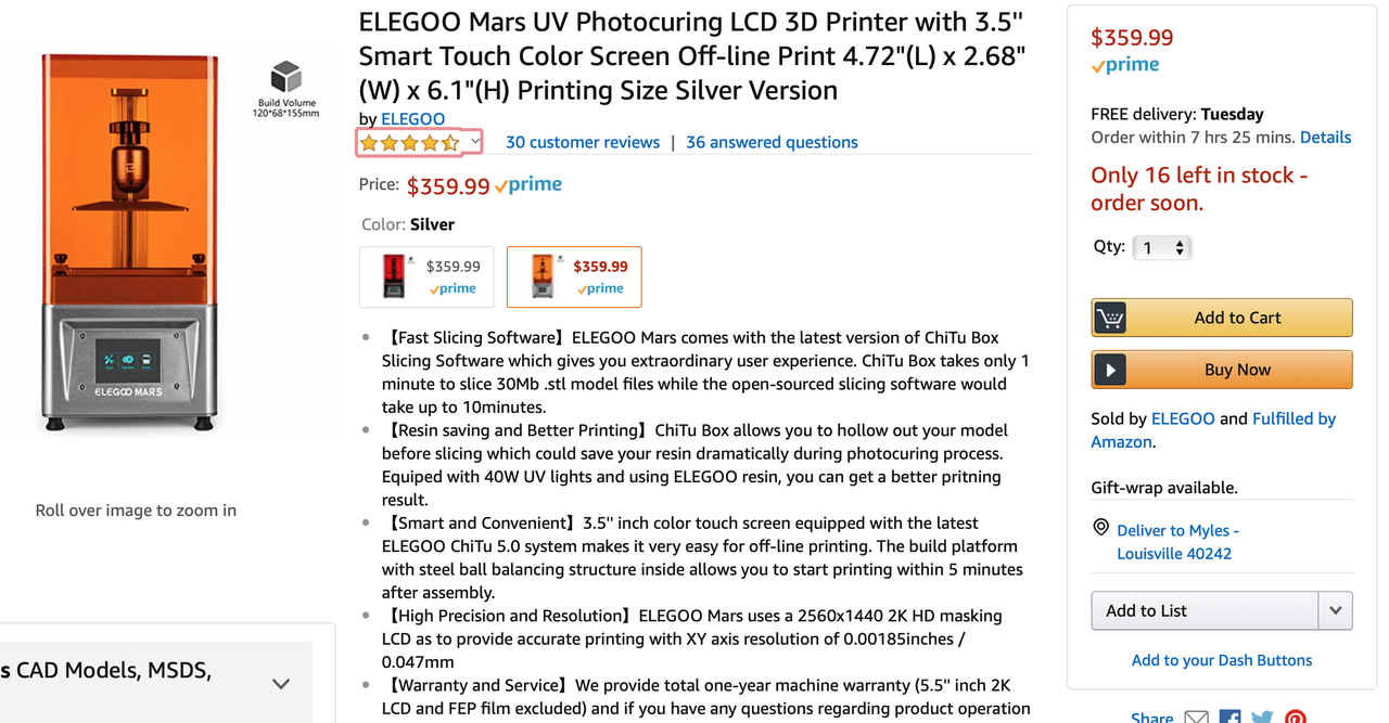

On another topic, I've been getting some things 3D printed at outside sources. These jobs have generally cost me about $40 each for some very small stuff that I didn't want to or have the skills to create myself. But the Filament Additive Machines (FAM) generally only get down to about 100 microns (a 1/10 of a millimeter) which at 1:32 and 1:48 scales show up badly. You need to have them printed on an optical resin machine. These traditionally are very expensive, starting at about $3k and then going up... way up. Then I read about units that use UV LEDs instead of lasers and are being sold on Amazon for under $400, and they produce 10 micron layers. These work very well for model work.
The unit above is Chinese, but most of the lower price 3D are. It uses a resin that's water soluble until cured and the models produced generally need more exposure to UV to become really solid. Amazon sells another UV that can be used to harden the models.
At this price point, if I do 10 parts, I pay for it. Furthermore, even though the resin is pricy ($40 - $80 per bottle) after downloading their slicing software, I ran the part that I just had done by Shapeways, and it ended up usng $0.72 worth of resin. Resin that isn't directly cured by the UV scan can be returned to the bottle and re-used.
I'm seriously considering this for a my father's day/Birthday present to me. My son, last night, said "For $360 what's the risk?" Exactly!

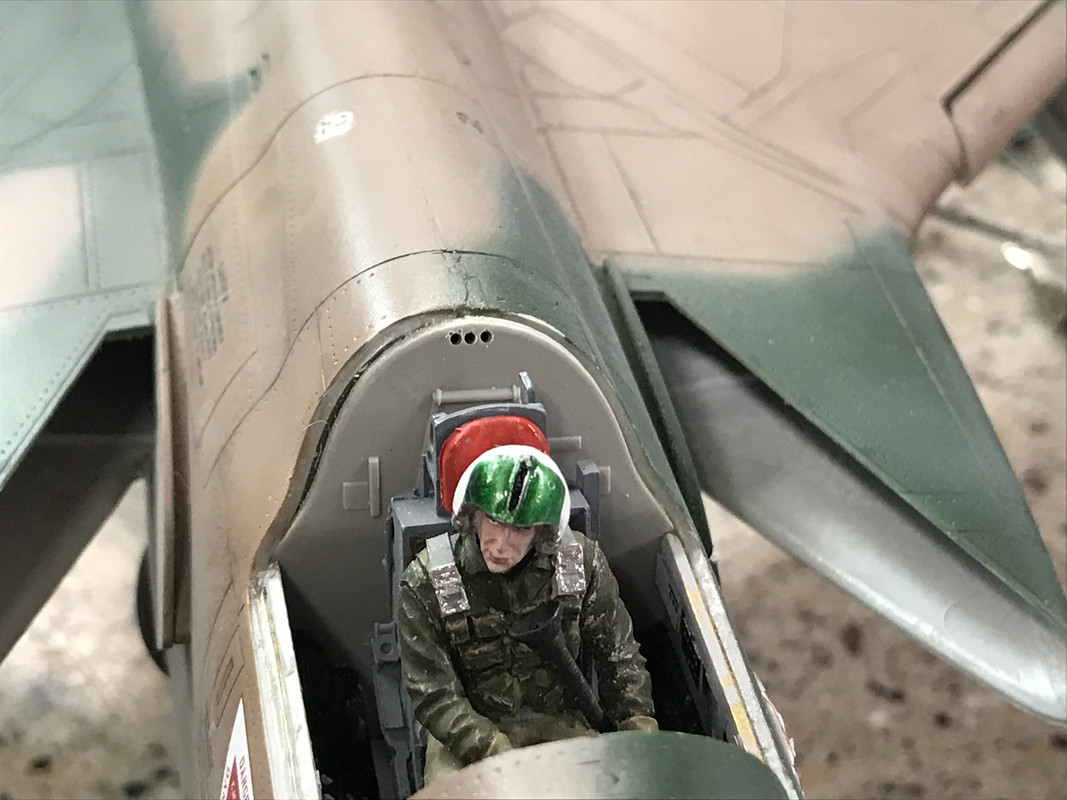

It's time to put all the little bits on. I wanted to install the upper red marker light. It, like the other plastic clear parts, had a lot of excess that needed trimming in order to fit inside  the raised rim. When I went to fit it, the darn thing fell inside the fuselage through the open hole at the bottom! Why in the world would they mold it with an open bottom? It will never come out since it's worse than getting a coin out of the slot in a piggy bank. So I went to plan B. Plan B was a bit of overkill.
I cut an over piece of the same shiny PE sprue and filed it to shape. Then, in the process of fitting it into the bezel, it too fell into the model through that %*((^@ hole!
Plan C was to make the oval out of thin card stock. Easier to shape and didn't matter if it too fell in the hole. After gluing in the oval, I used the chrome pen to make it nice and shiny and then with three layers of Bondic, made a very nice light lens. This I painted with clear red. Should have gone this route right from the beginning. So all the lights on the plane to this point are Bondic replacements.
I then built a custom nose pitot tube. The kit tube, besides being quite fragile, was out of scale, out of round and looked awful. From the get go I planned on making a metal replacement.
I used a piece of hard steel wire for the smallest diameter, a piece of 1/16" brass tubing for the large diameter and a piece of .8mm Albion aluminum tubing for the mid-diameter. I soldered the inner steel to the brass tube since the tube was a little bit oversized. I then used CA to hold the aluminum piece in place and then more thick CA to form the transition cones between the diameters. Forgive the shaky focus.
I had polished the steel before construction and then painted it semi-gloss black. I took the time to then add the 1/32" yellow tape stripe around the nose cone and the front was done.
The new pitot looks good and is very, very strong. The plane could be used as weapon if someone was so malevelently inclined.
I glued the windshield on with the Testor's Canopy Glue and it worked well, but there is a ledge that is not to my liking since, (as I've noted before) the Eduard cockpit raising widen the fuselage enough to make the canopy no longer fit the fuselage perfectly. I'm thinking how or if I'm going to do anything about this.
So here's the plane just before the other canopies are final fitted, the fuel probe and gun door put on, and the few little tiny Angle of Attach sensors are added to the fuze sides. There's a couple of spots where I need to touch up the matte finish. And the model will be done.

This is my 2nd post of the day since I did yesterday's this morning. The model for all intents and purposes is finished!
I'd rate this job a B+. There's a lot I could have done better, and some of it is just old Trumpeter engineering. After building the Tamiya Corsair, this was definitely a step backwards. I finished up the day with put all the remaining stuff including the air brake petals. According to the Squadron book, when landing, only the side petals were opened. The top would foul the parachute release and the bottom could impact the ground. Before gluing them on I did a quick dusting of Highlight White powder. According to references, the J75 would put a white coating on the exhaust stack.
I added the angle of attack sensor and painted it after it was on the plane. I put on the refueling probe and the gun door. After putting them in place I did some touch up painting. I touched up the windshield joint, but didn't attempt filling it. I'll just let it be. I did the job in my head and found too many ways to screw up what already was done.
The last thing I did was add some shims to the canopy hinges and the put them in with J-B Weld epoxy. Tomorrow, it will be hardened and done. I'm still toying with those auxiliary gear door levers and scratch-building the missing ones. Or not.
I put up some new backdrop paper and it really makes for some snazzy pics!
Note: When I took the pics the canopies were just hanging there. I actually glued them in tonight after we got back from dinner.
