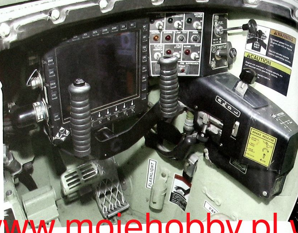

Here's an interior shot of a real one for color comparison. To my eyes it's pretty close. This vehicle shows steering levers. This vehicle looks like an M113 since there's now turret. This is the vehicle I talked about in the first paragraphs. It has steering levers not a yoke like the Bradleys have. But sea foam is still sea foam. These were powered by Detroit Diesel engines.
I also used a Sharpie gold marker to highlight the "brass" armor fasteners. It's called out in the instructions to paint them brass. The brass marker is much more precise (to me) than a brush since the quantity of color is very consistent on the tip.

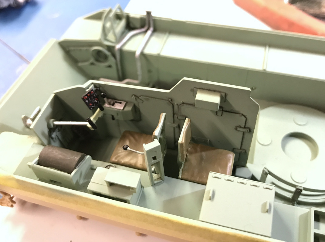

Work progressed on the left side sponson details. There are various shapes that get glued in place. Since I had already painted the gluing surface, I scraped off the paint so the glue worked better. There are some operating things included that will need knobs and gadgets picked out with color. I need to find some images of some this stuff to know if there's anything particular I need to pay attention to.

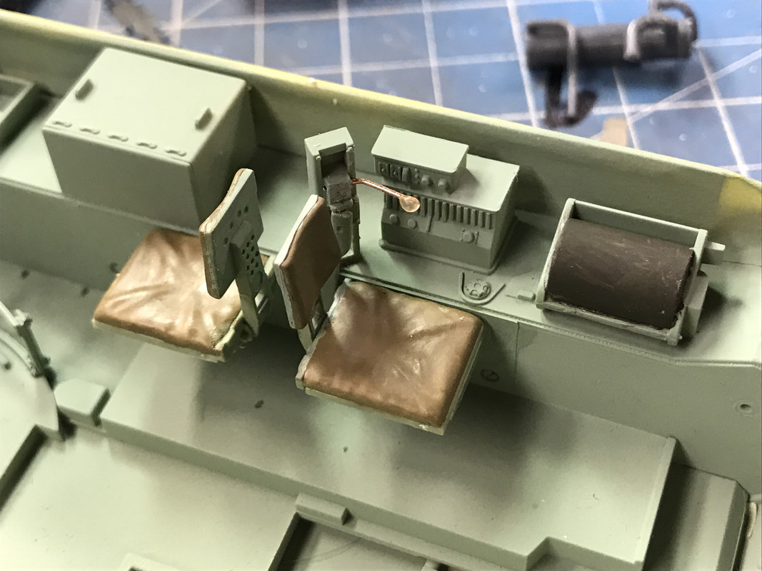

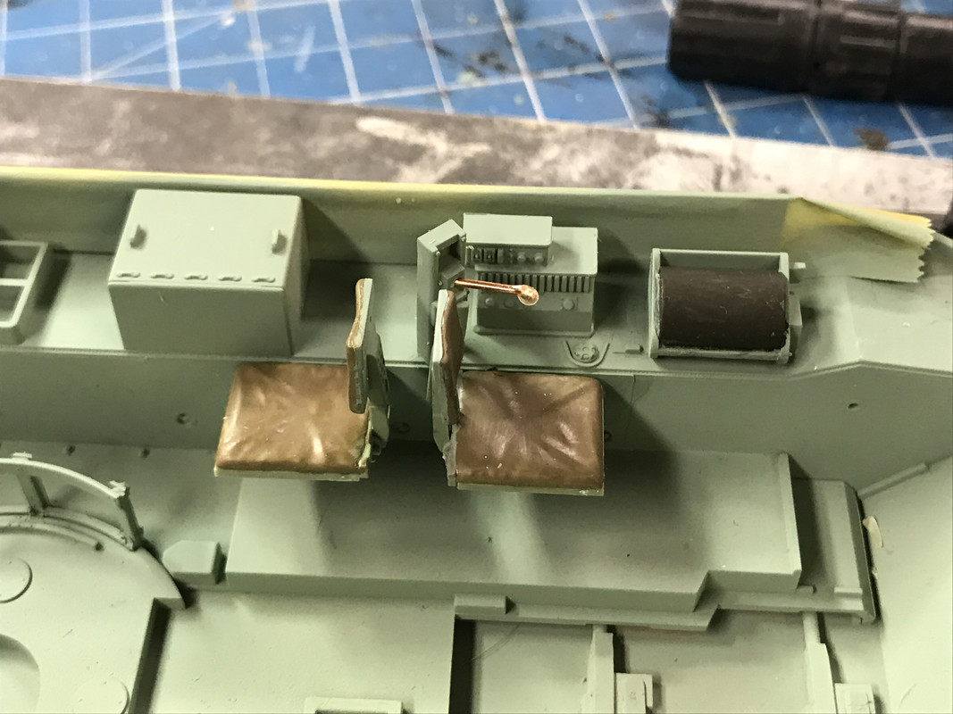

The instructions called for assembling the seats at this time. The driver and backward facing passenger seat are assembled and installed, the others are built and set aside. The seats consist of lower frame, seat and back. The lower frames sit in positively located holes, but I found the seat was moving all over the place as I was trying to place the frame, so I curled some Tamiya tape and secured it to the bench. It still moved a little, but was much more controlled. I had airbrushed the sea foam on the frames while on the sprue.
I let the frames set up before attempting to glue on the backs. The backs also had positive engagement, and they too required some time to set up since it was a delicate joint. Here are the passenger seats assembled.
Seat cushions are called out as Khaki. I first pre-coated the seats with Dullcoat by brush to seal the Tamiya sea foam. Experience tells me that using another Tamiya color over the seat would dissolve the bottom coat and mix the colors. Sealing it stops that completely. I did the same thing on the rubber floor pan. The Khaki, for some reason is drying kind of glossy.
The driver and backward seats can get glued in now, but the rest wait until the interior is almost complete.
I'll probably dullcoat the seats and maybe weather them a bit.

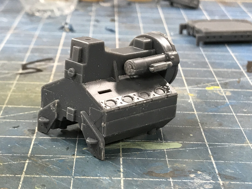

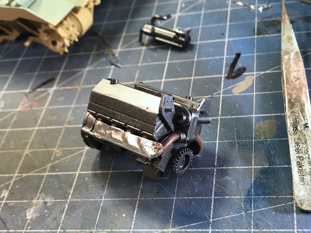

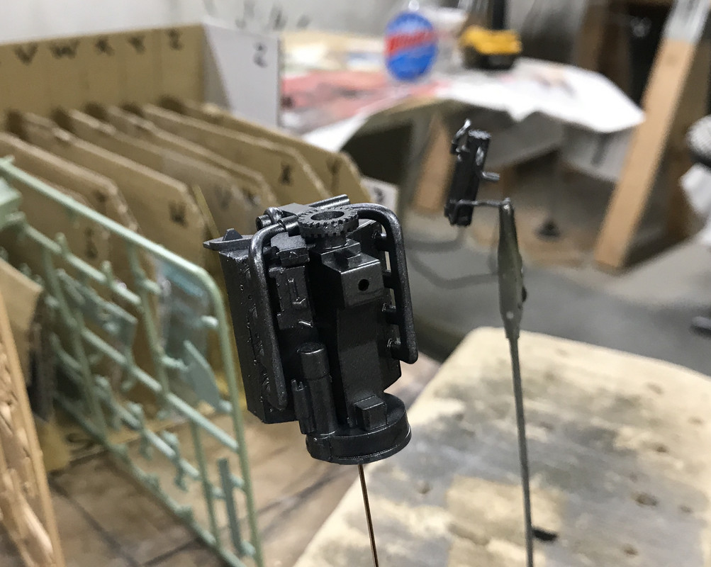

The engine assembly is next and I got the block assembled before my work time was up. Wasn't very clean with the glue. The engine will be completely obscured when installed in the vehicle and it will be painted so most of my slop will not detract from the build.
This Cummins Diesel is a very clean design. Everything is buttoned up and there's very little plumbing to be seen on the exterior. And again, it will be buried. The radiator sits directly above it (that was also assembled today) and the air inlet boxes and filters flank it. The large transmission sits in front of the diesel and it's what you see when the "hood" is open.

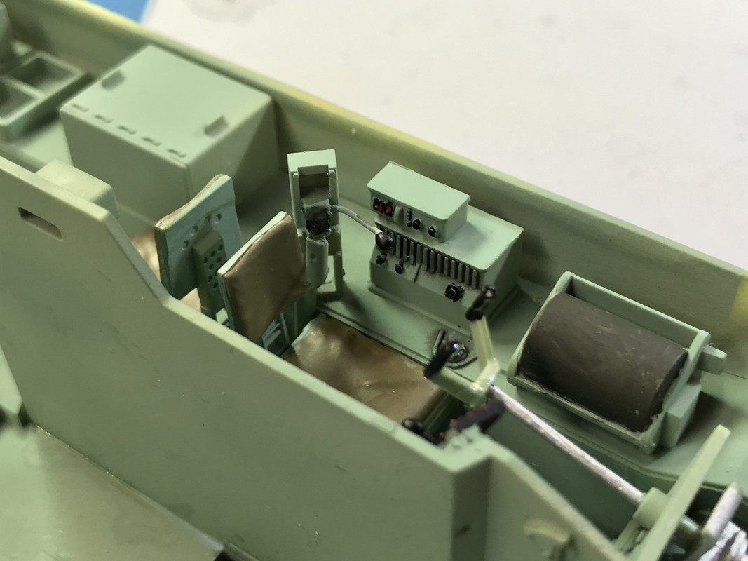

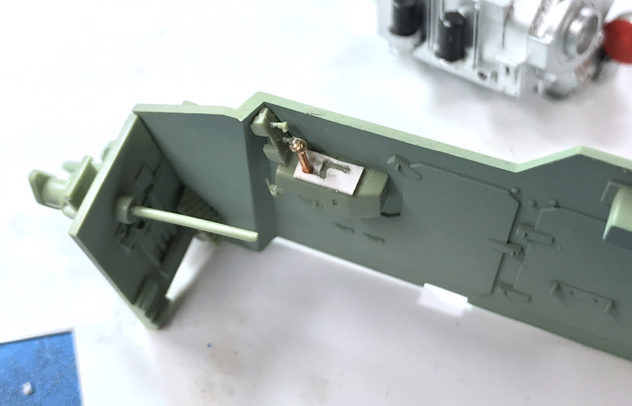

Looking great so far.  One pointer that is an easy fix and adds a bit more detail.  Meng missed the lever to adjust the height of the driver's seat.  Tamiya got it right over 30 years ago on their M2.  You can see where I added it on my M2A2 backdate of the Meng kit below.
More here: https://armorama.kitmaker.net/modules.php?op=modload&name=SquawkBox&file=index&req=viewtopic&topic_id=241594

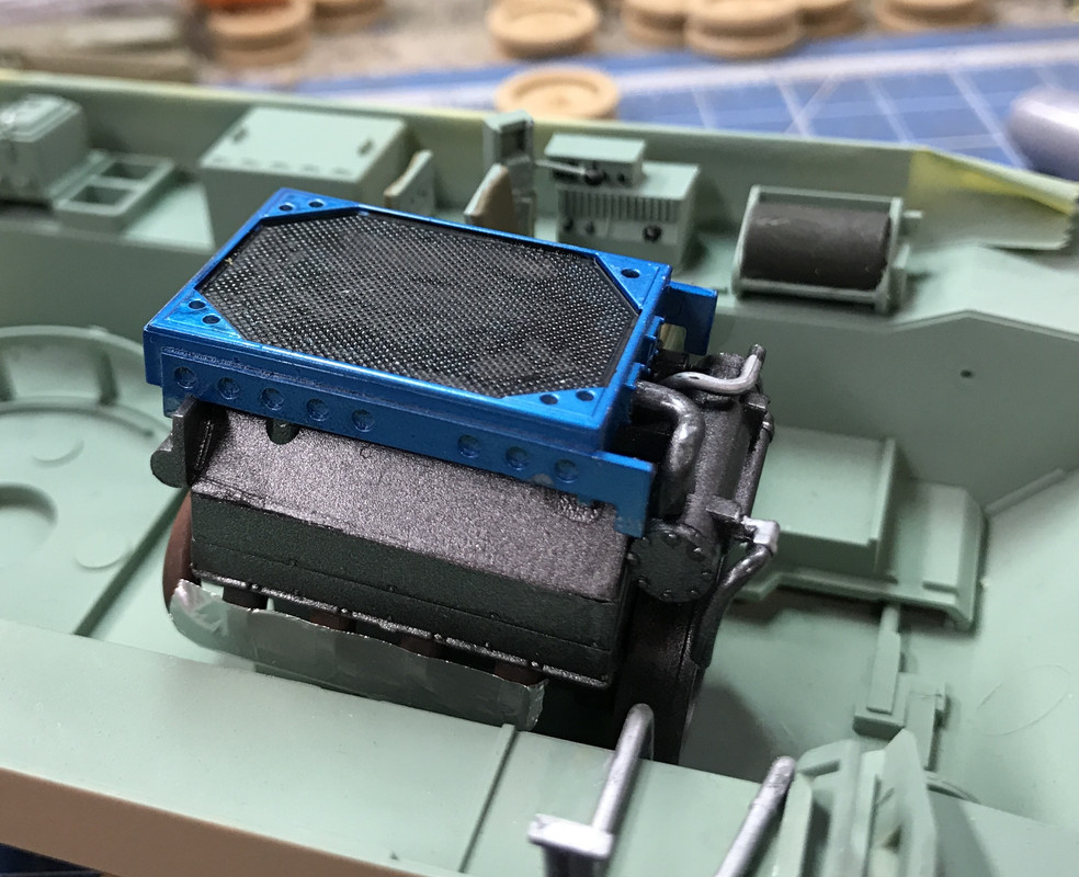

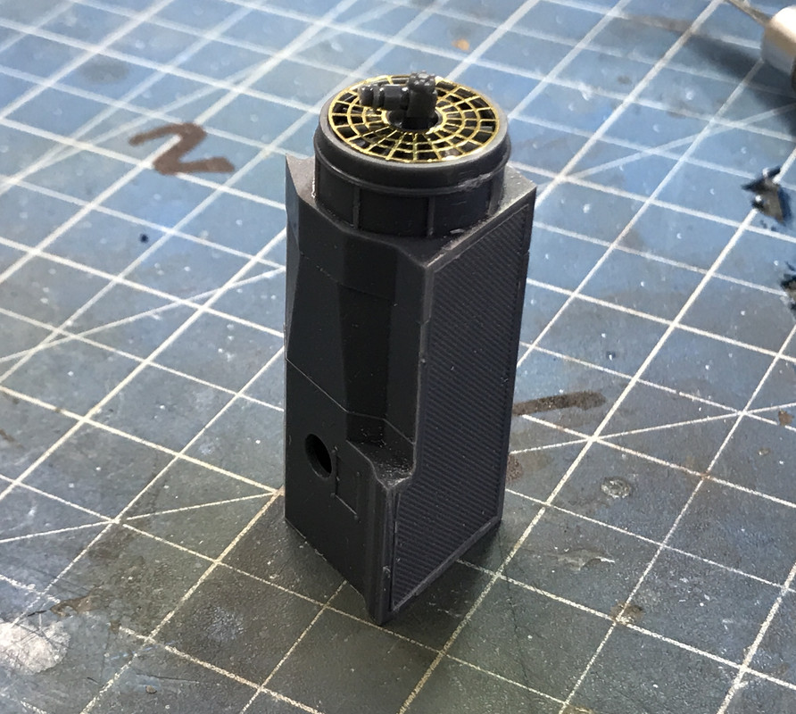

Posted by Builder 2010 on Friday, February 26, 2021 9:00 PM
Heavy Arty, the reference photos were GREAT! I didn't post last night so y'all in for a bunch tonight. BTW: I wasn't going to mess with the levers, but did. And furthermore, I wasn't going to mess with the gear shift, but when I broke of the kit's, I didn't have a choice and happy I did.

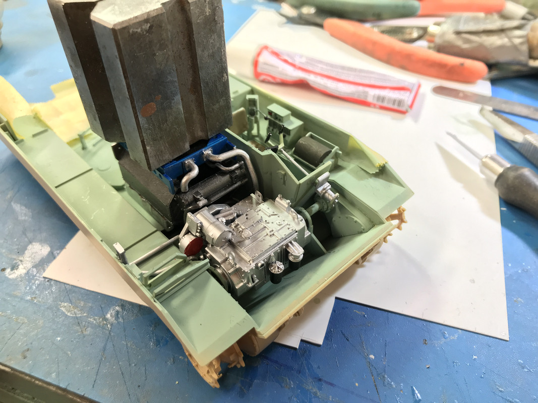

Yesterday was mostly Power Pack day. I built the engine, hydrodynamic trans and started working on the driver's compartment. After looking for about an hour to find good pictures of the Cummins VTA930 turbo diesel, I ended up doing what the kit suggested and airbrushed it all gun metal. When pulled for maintenance, the engine is all sorts of colors, but you can't see the darn thing so any time I spent on this detail is going to go unnoticed.
Here is the assembled engine. The Cummins engine is a modern design and therefore has streamlined shapes, very little visible piping and is clean.
Pictures I found, in addition to showing the typical heat-rust appearance of the exhaust headers, also show a heat shield on the outside. So of course, I had to add them.
The headers go into the bottom of the turbo manifold. The turbo seems a little smalll and insignificant compared to pictures of the engine, but I'm sure that Meng got it right.
After the gun metal dried I overpainted the headers Dark Iron and then add rust pastels to give it that "used header" look. After that I add some Bare Metal Foil brushed aluminum for the heat shields. Too bad you won't see this either unless I build the model with the upper half removable like I did with the Sherman.
The radiator sits on to of the engine. The intructions call out "Blue" as the radiator frame color. Again, the reference photos were very ambiguous regarding this component, so I took some artistic license. I decided the frame would be blue anodized aluminum. In other words, silver overcoated with Tamiya transparent blue. You do see the end of the radiator from the open engine hatch. The radiator core is flat black and is up against the roof so you'll never see that either other than in my photos.
The silver was Tamiya rattle can silver and the blue was airbrushed.
There's another large coolant pipe that runs from a heat exchanger to the water pump inlet on the block's lower side. The pipe has some springiness and made gluing it difficult so I immediately decided to drill 0.032" and pin it with some phos-bronze and medium CA. It won't come loose.
The GM-Allison Hydrodynamic Transmission was a simple glue-all-the-pieces together job which I again rattle canned with the Tamiya Silver.
So the power pack is done and ready for install.
The tank has a huge air cleaner, bigger than the engine. The Bradley is extensively used in desert service and turbo-diesels don't like dirty air. In front of the what-looks-like hydraulic motor driven fan is the first piece of photo-etch on the model.
Again, I painted it like I did with the trans. The filter's intake was painted flat black and it too will be invisible to the naked eye.
Today concentrated on the Driver's compartment and installation of the power pack. Since Heavy Arty pointed out that the model was missing the driver's seat adjusting lever I decided to add one. My first attempt got two things wrong: I put it in the wrong spot and made it out of too-heavy stock. So I filled that hole, drill another in correct location and redid the lever with thinner 0.022" stock.
Here was the wrong way,
After spending a lot of time to find an image of the real tank that showed this lever, I built the corrected version. I used UV-Cure Bondic to form the handle ball.
And here it is painted.
From the same set of Heavy Arty images that showed me the seat lever, I also saw what he did with the shift lever. The kit's impression of same is weak in appearance. It also turns out that it was weak in strength as well. I wasn't going to mess with this detail, until I broke off the kit's lever. So I built it back better. I removed the surface of the shifter plate and fabbed a piece of thin styrene and another phos-bronze lever. This time I used the thicker 0.032" stock which looked okay in this instance.
Here's the compartment with the lever painted. I also used some panel accent to dirty up the access panel seams. I painted all the doodads on the control panel, added the steering handles and did some more accenting on the controls on the left side of the panel. This was all after gluing the bulkhead into the vehicle.
And here's the actual driver's compartment and my lever isn't actually rights. The real lever is stamped out of sheet metal and the knob's not exactly round. The entire wheel is black as is the gear control box. There are decals that need to go on. I may or may not fix this discrepency. Talk me off the ledge... The kit called out many of these details as interior green.
Reverse view,
With this critical bulkhead in place it was time to glue in the engine and transmission. The engine glues into single point at the bottom of the oil pan. I'm surprised the kit didn't actually model the motor mounts that a real engine would require. The Rye Field Sherman had very detailed engine mounts.
The front of the engine engages a shaft that comes out of the transmission and this sets the engines fore and aft angle. You really need to glue both engine and trans in at the same time since they do interact. I put a weight on the engine to ensure that it was seated well in the square, fenced-in recess in the floor pan.
I left the job today with the engine and trans fully installed. The tank can now move under it's own power. It must be a hoot to drive one of these babies. They have lots of horsepower (600+), automatic transmission and a 'normal' acting steering wheel instead of pulling levers.

I changed the coloration in the driver's compartment and added the decals. I found that good interior picture and it shows the entire steering column and wheel are black as is the entire gear shift box. Meng decals work very nicely, don't take too long to release from backing and have very tight margins as can be seen by how the large spec decal fit around the panel clamps. They were actually notched there so no decal softener was needed.
The other trans coolant line went on followed by the first of the steering clutch and shift linkage on the trans. The transcooler is a tubed heat exchanger that uses engine coolant to transfer heat from the trans fluid. I suspect it cools the trans first and then goes into the engine after leaving the radiator. Also glued the air handler in place.
I got the passenger seats in place after putting in some piece of plumbing that goes between the turret and sponson on the right side sponson wall.

The troop seat cushions look really well done; are they like that in the kit or did you do something extra to them?
Still a very well done build.
  • Member since
    December 2002
  • From: Valrico, FL
Posted by HeavyArty on Tuesday, March 2, 2021 3:51 PM
It looks like he painted the kit parts as they come in the box.  As I said, Meng did a great job on their Bradleys.  They are super-detailed and look great when done well as he is doing.
Builder 2010
Meng isn't totally wrong on the color for the steering yoke and shaft parts.  It is also seen in seafoam green.  An older model in the first pic.
Newer M2A3s have them too, note the newer black gear-shifter box in the second (slightly blurry) pic.
The Bradley has been around since the early '80s and has gone through a bunch of different upgrades.  There are many different variations seen across the current fleet.

The seats are molded as you see. All I did was brush paint Tamiya Khaki directly from the bottle. It has some slight refectance and the actual seats do to, so I didn't dullcoat it.
So black... sea foam... seems like both were used. I'm now sticking with black since I've already repainted once. Short session today so all I got done was to scratch-build that box that has NOT re-appeared from quantum dimension. Simple little thing. I also built the bulkhead that goes adjacent to the turret wall. I will install that tomorrow along with redoing a pipe that broke off from an undescribed piece of plumbing that goes into that bulkhead. I will use fine-gauge solder wire.
