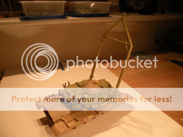

Have decided to jump strait into my next project.  Converting an Italeri M60A1 into M728 CEV.  I picked up an AEF Designs conversion kit off of E-bay several months ago.  Very soon after begining to size up the various parts of the build it became obvious that the AEF designs product  falls very short in the quality department.  (I've seen several warnings of these issues w/AEF Designs in various theads on this site)  The main component of the conversion kit (the turret) is very poorly executed.
The AEF kit appears to be made to convert  the Italeri/AMT/ESCi kit.  The pins & holes are the only thing that line up.  The gaps are huge in several areas, the mounts for th boom are very poorly attached and no even close to being strait. ( $80.00 + retail for this ?!?!?!....)
DSCN1235.jpg picture by 1SGDavis
With all the turrets faults I decided to set it aside and work with the Italeri turret.  1/2 an hour with a drill bit, pin vise and some files and I was ready to go.  I had some round plastic stock that fit into some round aluminum  stock perfectly.

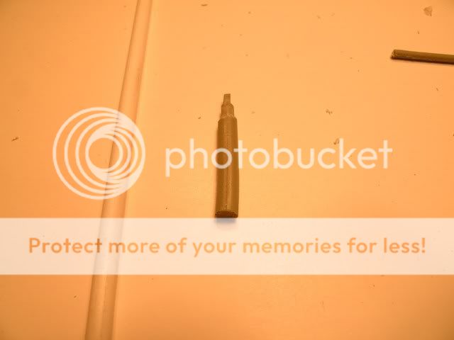

As I mentioned in my previous text only post,  I once again I found myself recreating a botched AEF part.  Their lift cylinder was warped beyond use
DSCN1243.jpg picture by 1SGDavis

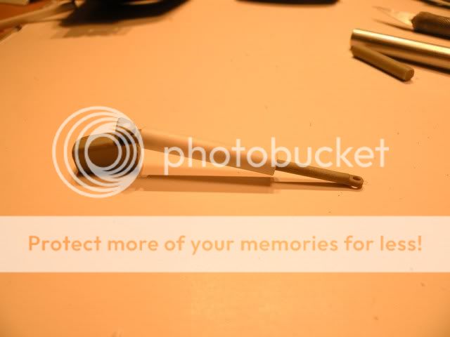

With a couple of pieces of hollow round stock and shaving down the rod I was able to scratch together a respectable replacement.  I used some solid round stock to pin it to the housing mounted to the turret side and also to the bracket on the boom
DSCN1245.jpg picture by 1SGDavis
Careful placement of glue and fitting a sleave inside of the cylinder for the rod allowed for full movement of the cylinder & boom after assembly which will give me a few different options for display once I'm done.

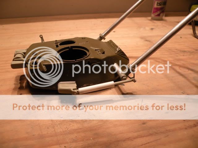

This next picture flashes forward quite a bit.  I've completed the major structural assembly of the boom.  I used several layers of white glue around the boom mounts on the turret to simulate the heavy welds.
 I completely re-worked the original kit rear stowage basket that previously ran the entire back of the turret into something more like an oversized laundry baasket.  Brass mesh was installed to finish it off.
All of the rail mount holes on both sides of the turret have been filled and sanded
The left side of the boom has nine climbing loops (?) welded on to it.  I drilled out the boom and used copper wire to create these. Again, white glue was used around where the loops went into the boom to simulate the welds.
