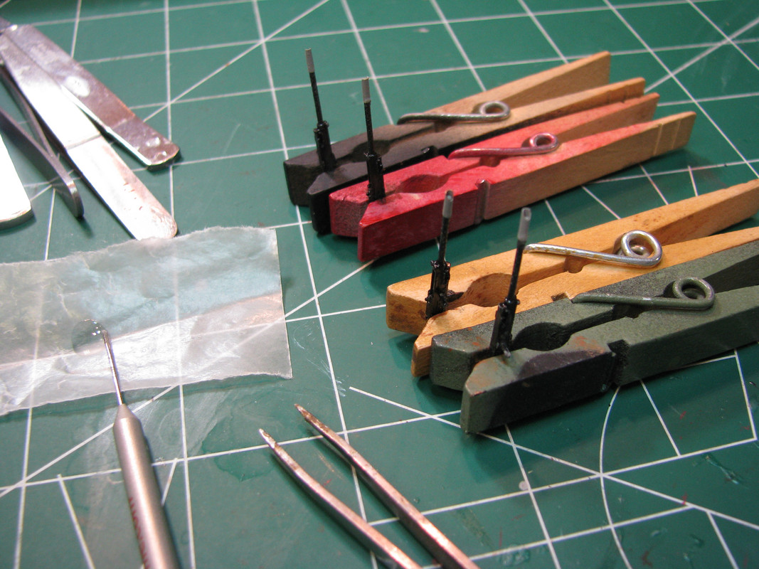

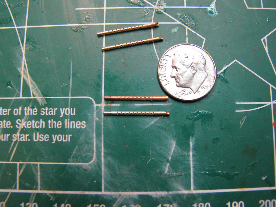

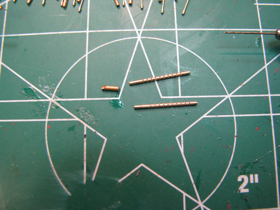

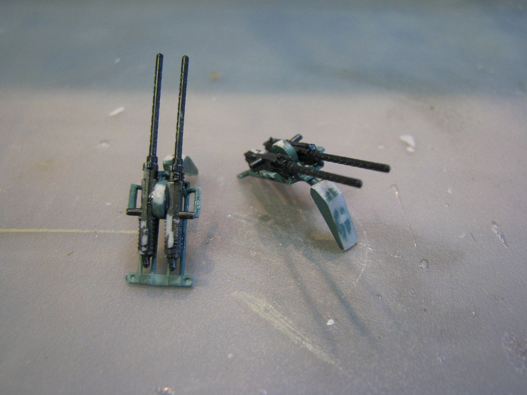

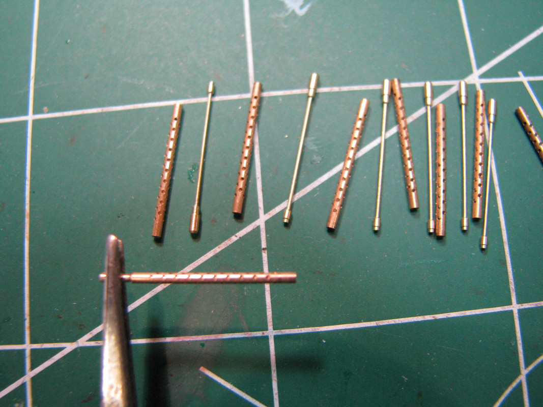

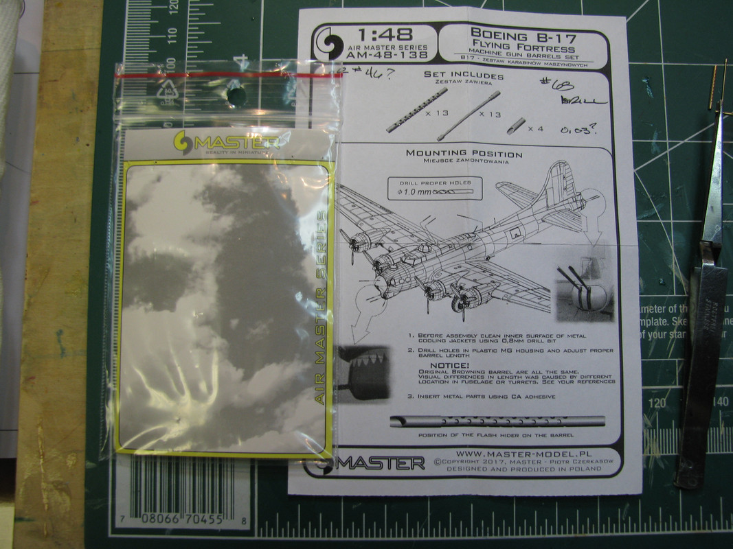

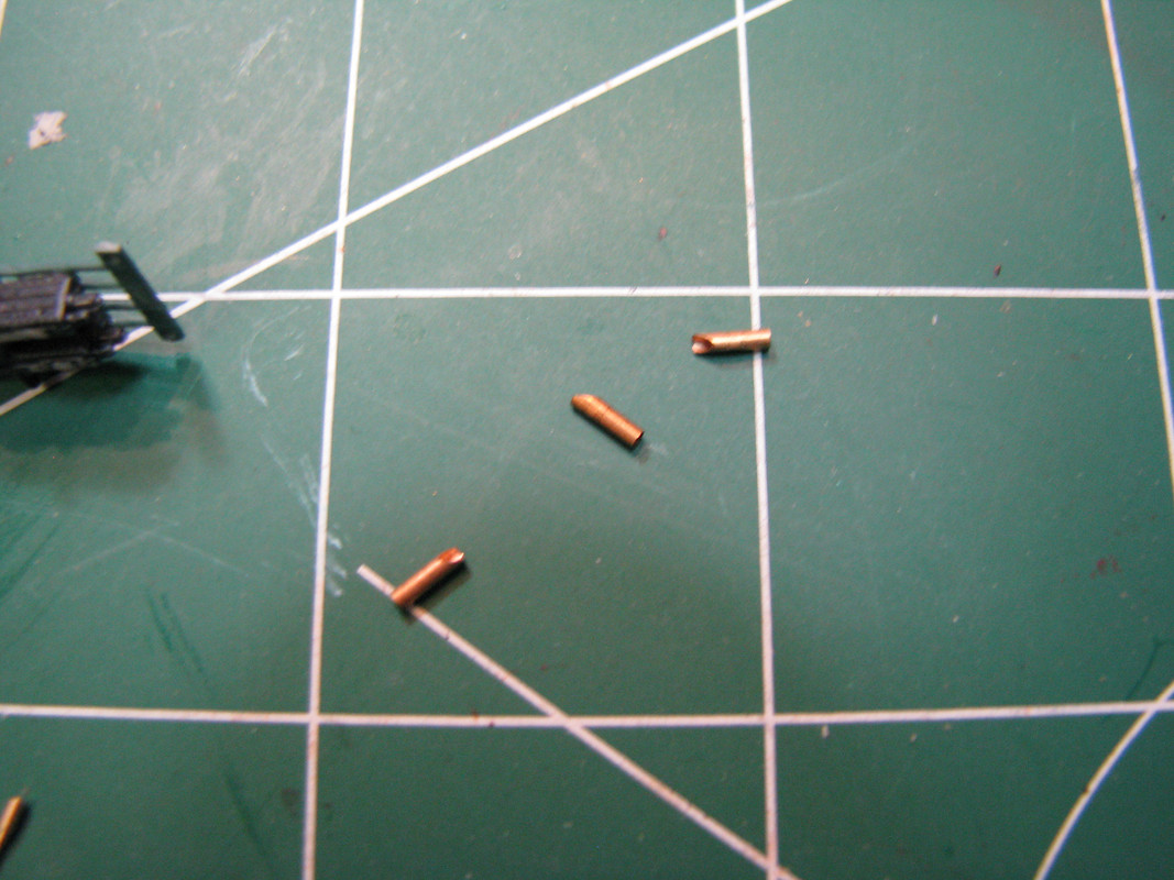

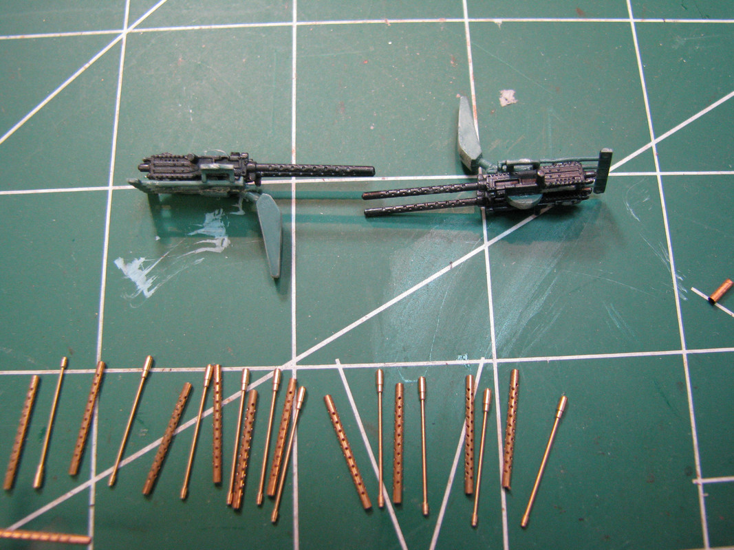

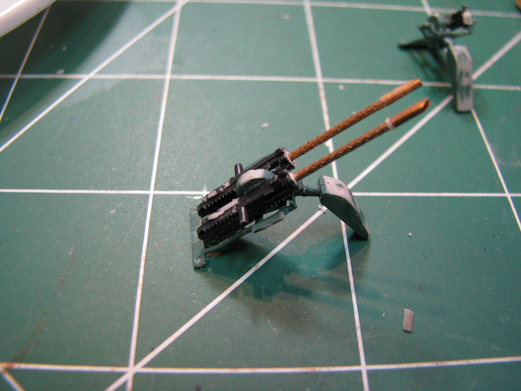

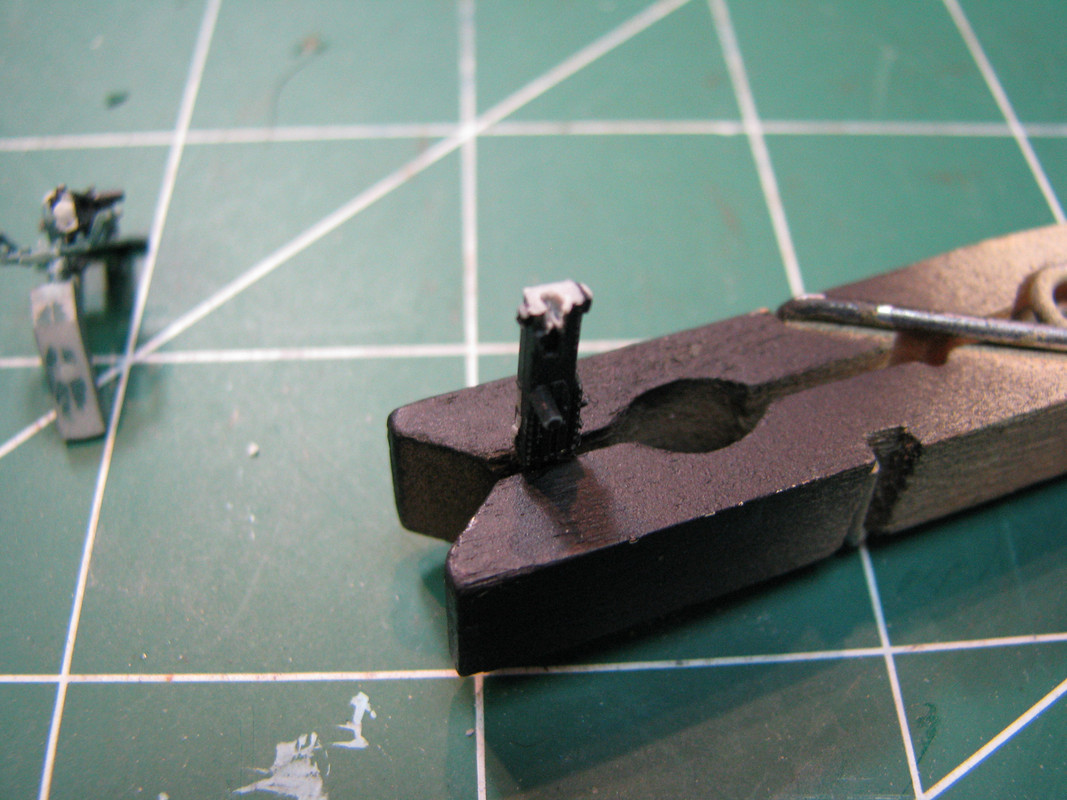

As promised, here begins a tale of whoa and hopefully a solution. ie. "Happy Machine Guns."
The kit provided .50 cals were adequate to say the least. As seen here
Not being someone to leave well enough alone, I was going to enhance them with metal barrels from Masters Models' 1/48 B17g combo. Mainly because they cam with flash supressors as seen here.

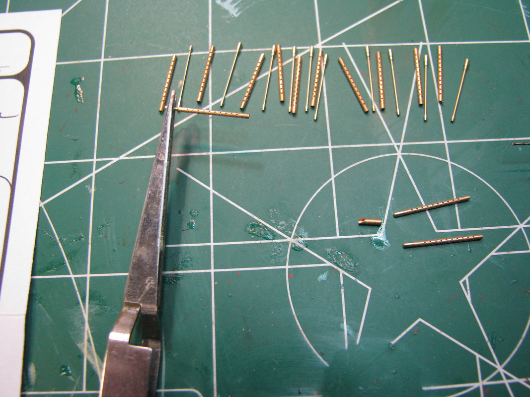

So, surgery was begun with the glueing of the barrels with the flash supressors as seen here

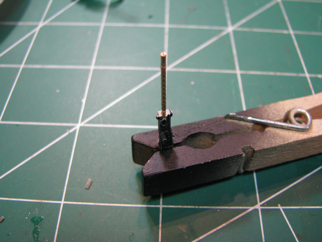

The first part of the surgery was successful and high hopes were to be had

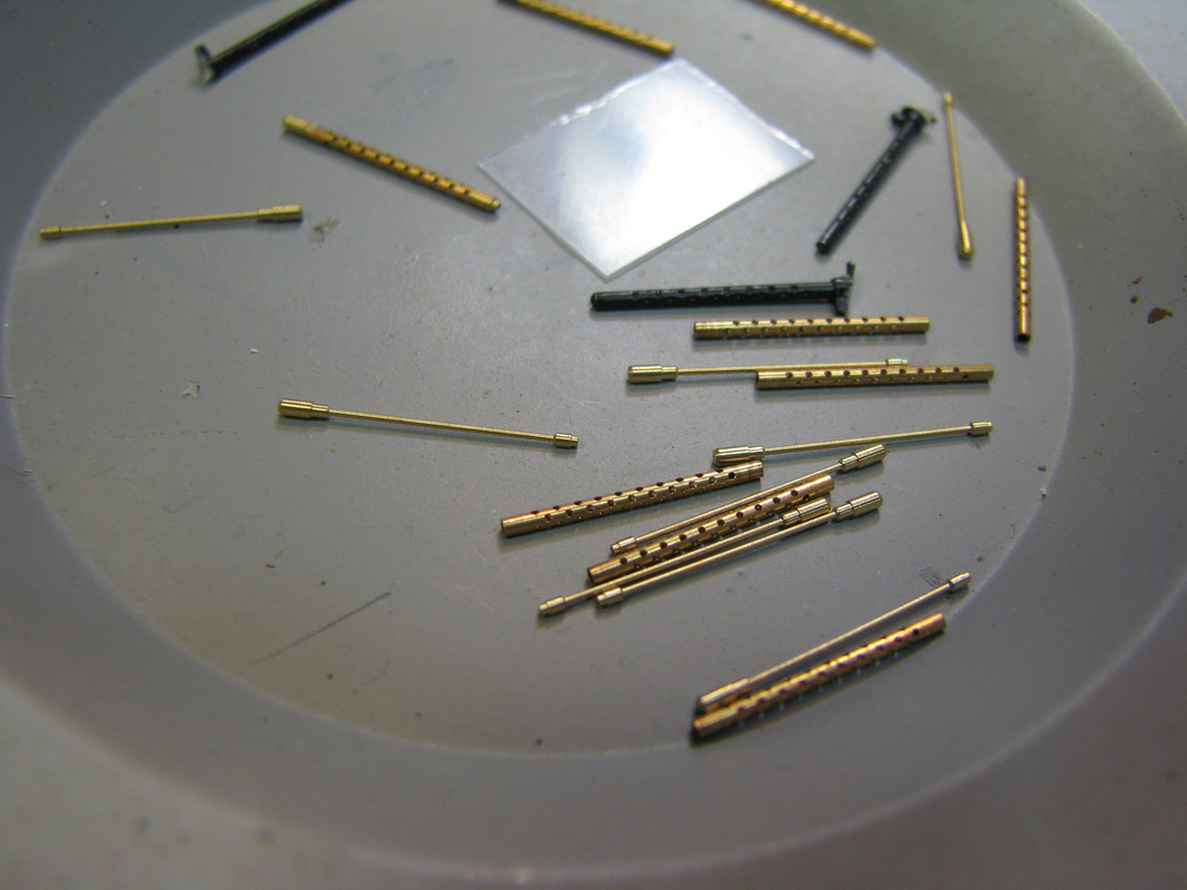

The dismemberment was also successful as seen in this picture.
And the mating of said barrels to the stock was successful at first
First set complete and not too bad, if I say so myself, which I do, although a bit of clean up would be required
Now, one would think that being fairly successful on the first set that the next would be a piece of cake....... except that fate, a harsh a mistress as there ever was step in. Whilst and at the same time, drilling the hole for the last stock went sideways. Both literally and figuratively...
So, after cussing up a storm, I had to figure out what the heck I was going to do to fix this mess.
After trials that were unsuccessful, I remembered that Eduard sells some pretty nice 1/48 Brassin .50 cals. I procceeded to purchase said resin guns and so, test number 49,673 bore fruition. I unmated the the flash suppressors, you remember those really cool things that started this saunter down a twisted path, from the metal barrels and proceeded to mate them to the resin guns as seen here.
Then with a little putty and paint, they look like this. Except that I also painted the suppressors too.
And so ends this rather long and involved tale. So never give up, never surrender!

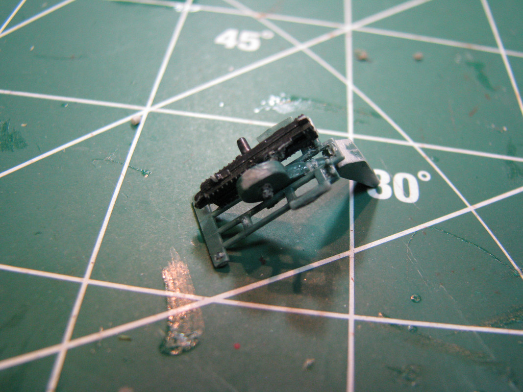

Now for another update. As I stated before, the gun supports on the Merit kit has the .50 cals at a perpendicular attitude. If you look at photos of the guns when not in use, they were usually pointing straight up and covered by tarps. Here is an example:
Steve
So here are the guns at the kit provided attitude
So to adjust their attitude I used a hair blow dryer very gently and not very long to pull them to a more upright position. I was afraid to adjust them to a straight up position as they might have broken. I'll post the completed guns in the next installment.
