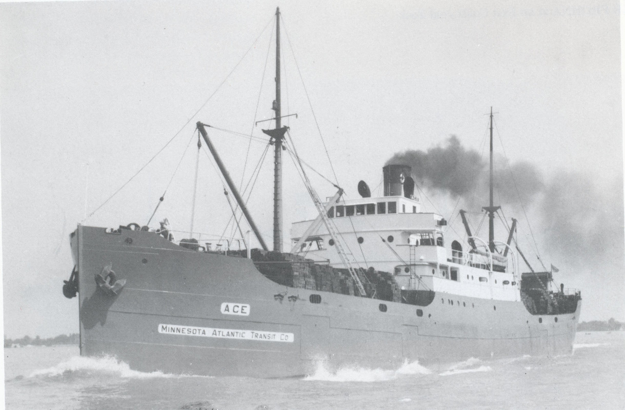

Awhile ago Lindberg re-issued one of their ship kits that they called a Q-ship.  When I saw the box art, I thought it looked familiar.  I looked through my references of Great Lakes ships, looking for ships of the so-called Poker fleet.  Sure enough, that kit could easily be built as one of that fleet.  Here is a picture of the Jack, one of the fleet;
 ( oh oh! I cannot seem to post that picture.  It appears in my draft, but then disappears when I actually post it.  I will see what I can do to get the picture in). Okay, let' s try something else.
Here is the box art of the Lindberg kit.
See the similarity?  Here is the story of these ships, and why the Lindberg ship might represent both a ship used in WW1 and a ship of the poker fleet.
A number of ships were built on the Great Lakes and St. Lawrence river to use the Welland canal and canals along the Seaway to link Great Lakes ports with the ocean commerce.  These ships were known as canalers.  During WW1 the US (and allies) needed lots of merchant shipping, and they issued contracts for any dockyard they could find to build ships, and ships built on the Great Lakes had to fit through the canals.  Many were built to a standard plan drawn up or approved by the Administration.  They overbuilt, and many just sat in port and rusted away.  One or more of these ships may have been used as Q-ships-  I could find no reference to such, however.
They were, however, sold to shipping companies for commercial use on the lakes, however.  Probably the most famous were the ships of the Poker fleet.  The Minnesota Atlantic Transit company bought at least four of these, and named them Jack, Queen, King, and Ace.  Hence they were popularly known as the Poker Fleet.
The ships were all pretty much identical.  I intend to build the kit as either the Ace or the Jack, the two ships I have pictures of.  The kit lacks detail, and has a slight simplification of the superstructure.  The front of the superstructure of the poker fleet ships has a slight curve, while the kit super structure is flat.  I will have to modify that.  Additionally, the railings of the kit are solid, to represent canvas covering.  However, usually canvas covering shows some detail.  I will look for PE in an approriate scale and show them uncovered.

That's a fun model. It has classic lines at the bow and stern.
I think you are right about the genesis. My suggestion would be to scrap everything but the hulls, as it's all pretty clunky.

Don, it's a fun kit to 'go to town' with.
Having tried a couple of years ago to approximate a real 'Q-ship' with it...which seems to be exactly the sort of vessel you're going for...I will point out the obvious by cautioning that the cargo deck/spaces both fore and aft are so foreshortened as to be virtually non-existent. The hull really needs to be stretched a bit to represent any type of self-respecting working vessel.

Hi,
Thanks for posting the image.  They do look extremely similar.  I still have my version of the Q-Ship model, converted/painted to look similar to a WWI Ferris "Wooden" cargo ship, sitting partially done on my shelf of doom.  Maybe once I finish up my current "Race into Space" & "DC-3" group builds I should try and get back to it Tongue Tied

Posted by Don Stauffer on Tuesday, December 18, 2018 10:16 AM
GMorrison
Yes, I find I do need to scrap the deckhouses.  What I had thought was a slight rounding of the front of the superstructure was actually a lot of camber of upper decks.  So I will replace those decks.  And the deckhouses are a biti narrower than what is in the kit.  And, I like to show windows in the bridge (the kit supplies window decals).  Additionally, the little shack on the aft of the spar (?) deck in the kit is not found on the poker fleet ships.
Greg, those short decks do seem to bear out canaler origin.  Those ships are limited to 261 foot length by the locks.

Posted by Don Stauffer on Tuesday, January 8, 2019 9:24 AM
Added beams with camber for the spar (?) deck, and laminated the deck from three pieces of 020 styrene.  Also added styrene stock to raise bulwarks up to spar deck.  Now have to fix details in the bulwark area.  Proving harder than I expected.
Also modified the bulwarks on the main deck, the curves where they meld with the upper decks.  Kit ones were parabolic curves, changed them to arcs of circle.
