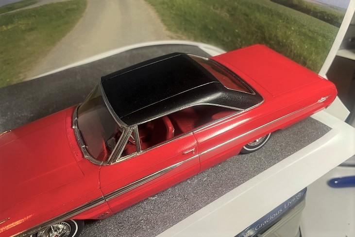

Posted by Tcoat on Tuesday, January 31, 2023 5:35 PM
The Extra thin works well becuase it does only impact the top layer so there is little risk of ectching the plastic too deeply. You have to brush a fair bit on and work quickly. Make sure you do the whole surface and then go over again in a random pattern. The vinyl tops had very little uniformity or pattern to them so you want to avoid things being perfectly even. I tried the over spray method on the weekend and found it to be far too consistent for my liking and cleaned it off and went to my old ways.
 I have used the same brush for years. The stiffer and more splayed out the bristles get the better the effect.
This is the one I did Saturday.
