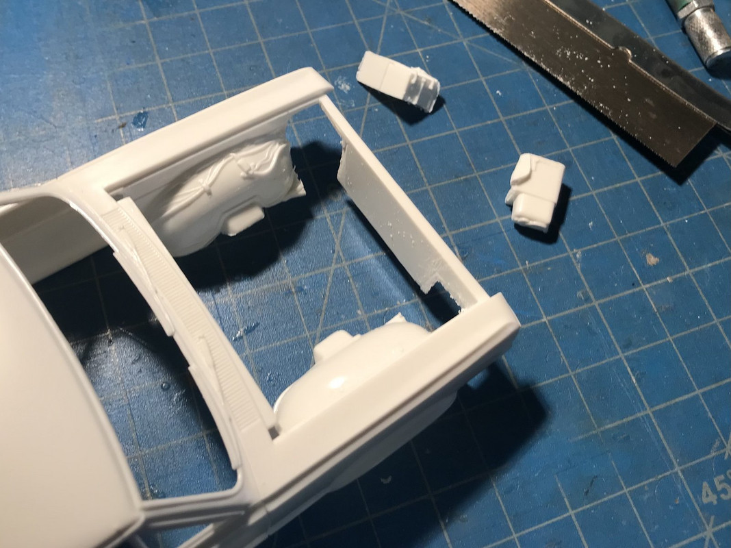

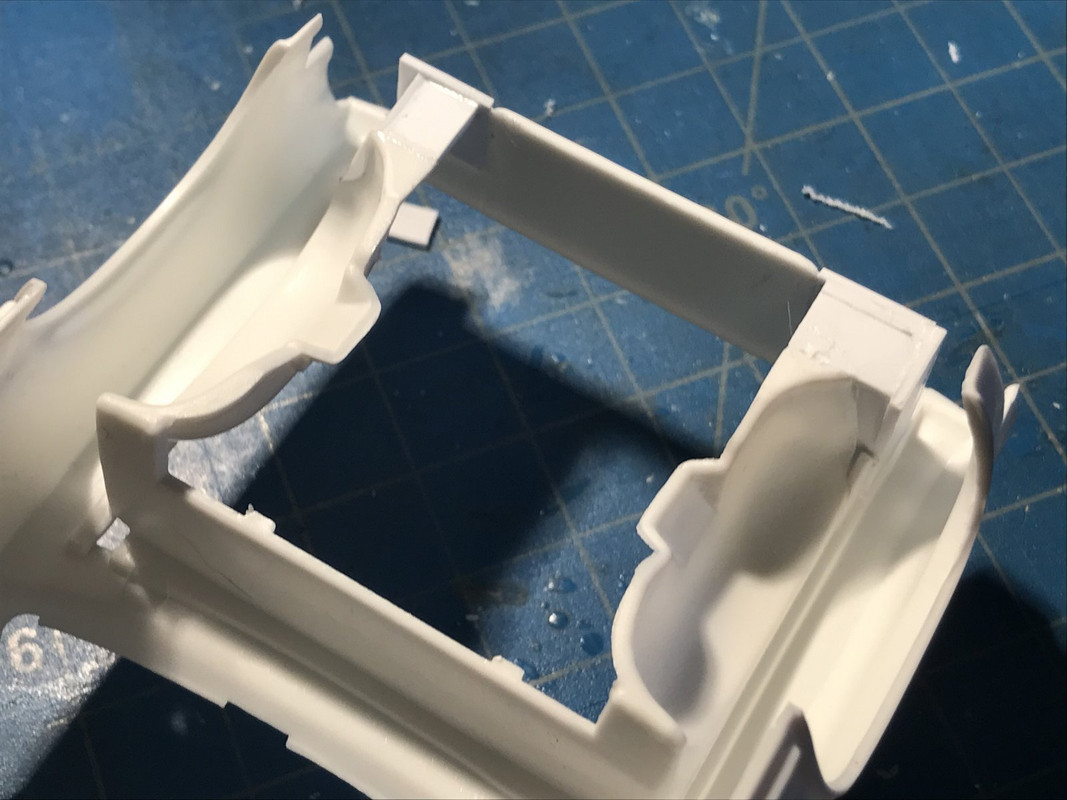

First step is to remove the molded-in battery and radiator water reservoir features on the inside front of the engine bay bulkhead:
I filled in the openings with Evergreen .040” styrene sheet stock:

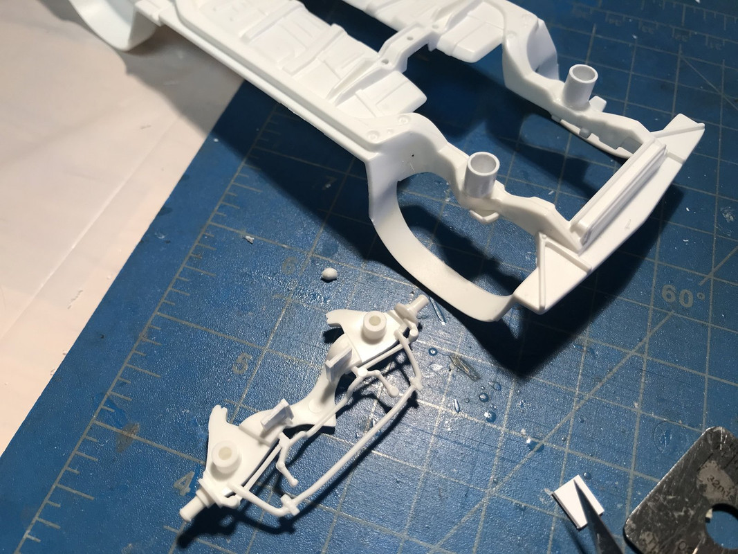

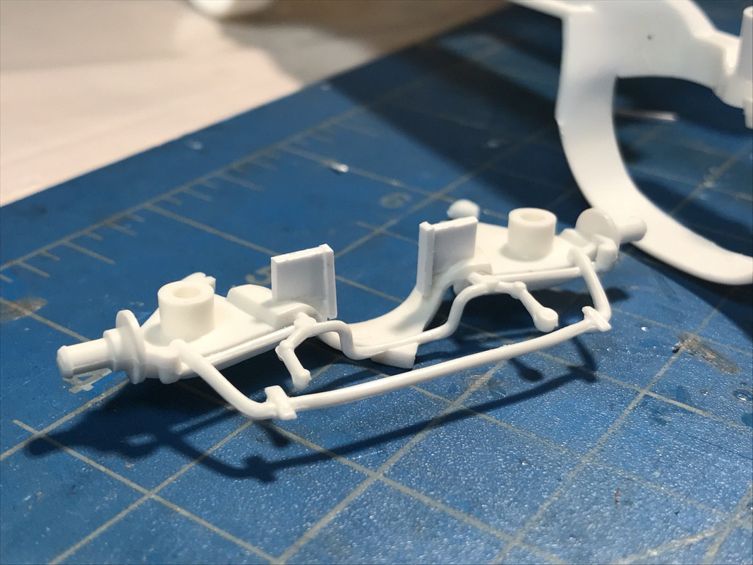

Next step involves bonding 1/4” OD styrene tubing spacers between the front chassis and front axle to kick up the front end for that ‘64 super stock “look”.  Coil springs would look better but I've decded to go simple with these underside mods and airbush the finished chassis in semi-gloss black to minimize visability:
I extended the heights of the two engine mounts on the one-piece front axle piece using more .040" styrene sheet to maintain the stock engine block position relative to the body/ chassis:
I’ll leave the rear end “as is” for now and reassess the stance once I have the final wheels and tires that I can dry fit with the body and chassis.

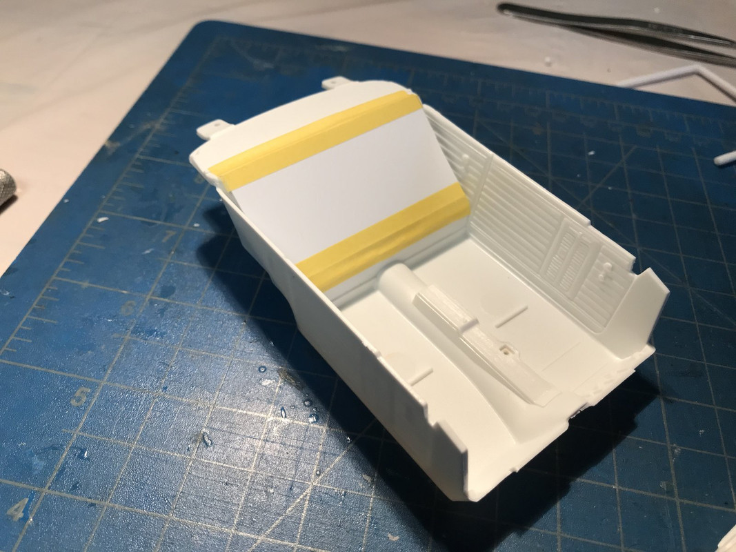

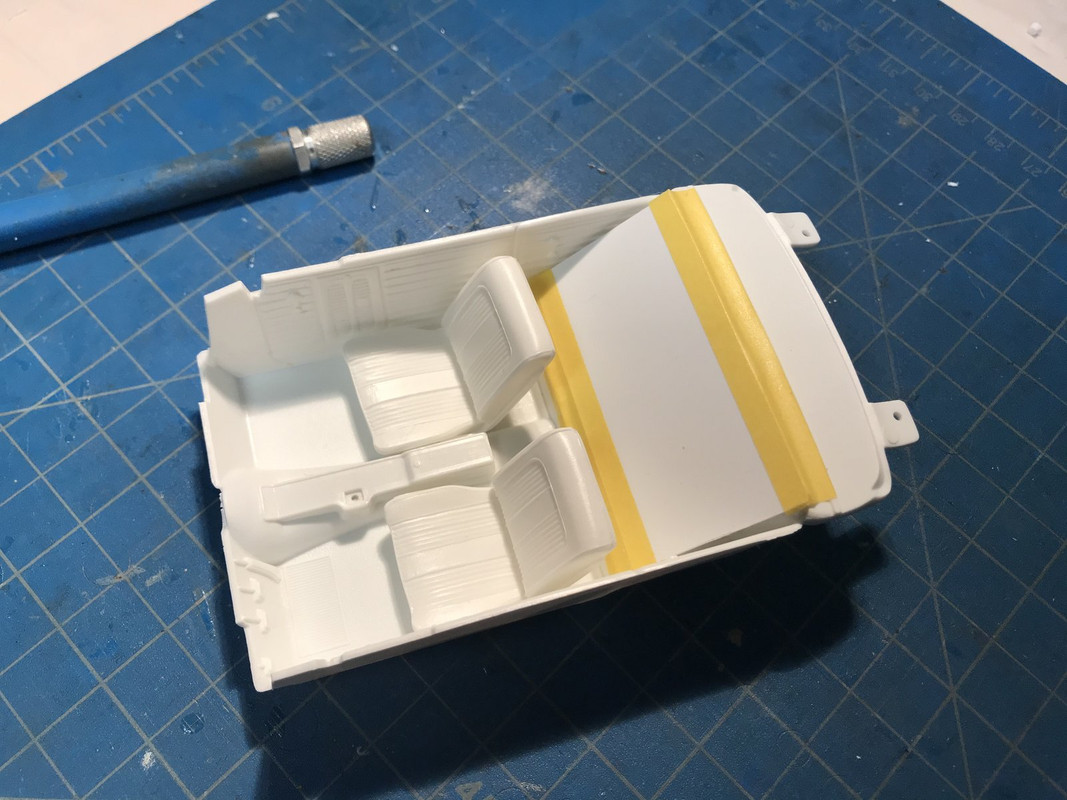

I thought about cutting out the rear seat and filling it in with styrene sheet but the rear of the interior tub would turn it into swiss cheese. I think just bonding a styrene sheet directly over the existing rear seat might be nearly as effective in terms what you will be able to see of the finished interior when everything is assembled - I welcome your thoughts/ suggesions.

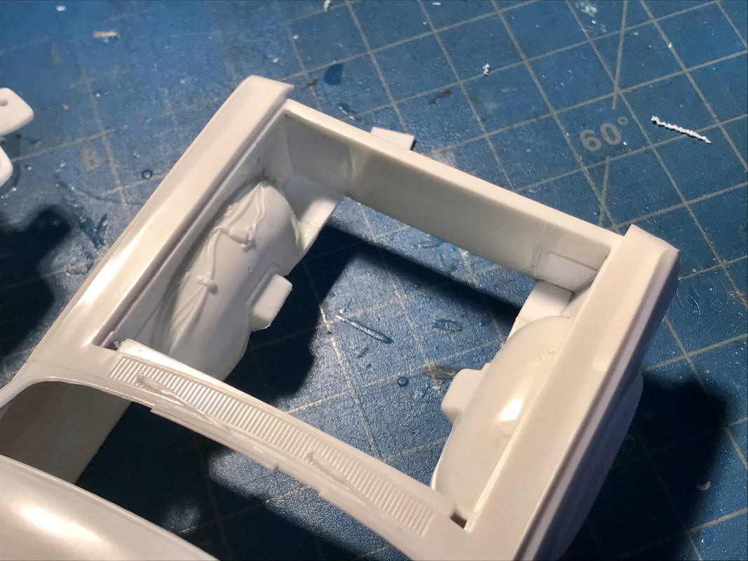

Big question for my fellow early 60's drag car modelers: What should I do about these horrid molded-in windshield wipers????:
If it were a '63 or older super stocker, I would leave them in but I have yet to see a picture of a '64 FX SS with wipers left in place.  Removing them and trying to clean this up could also lead to disaster/ regret. Thoughts?

(And the wipers definitely should go. It's actually a pretty easy cleanup with something like a micro-chisel, then carefully rescribing the grill area. And the 'sheet metal' blank for the back seat looks fine. If you wanted to get tricky, you could curve it slightly to 'suggest' the rear wheel well structure...but as you pointed out, not much will be that visible. Yes)
