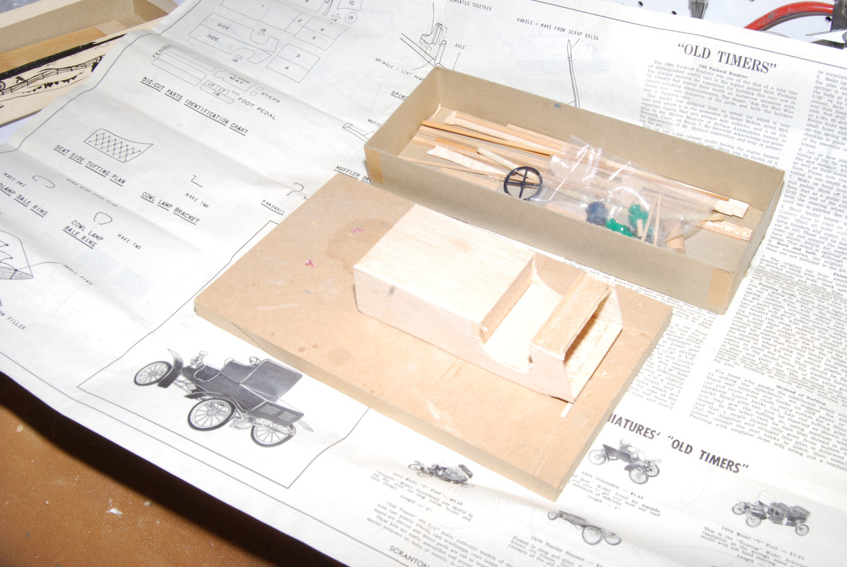

I have started a 1900 Packard, a kit by Hudson Miniatures.  This was a 1949 kit in the era when plastics for model kits were pretty new.  It has plastic wheels, steering wheel, and head and cowl lights.  The rest of the kit was balsa wood and cardboard.
This is real nostalgia.  When I started modeling, car kits were all wood, with composition (a mix of plastic and sawdust) wheels.  Some kits included cardboard parts.  I find it really fun to be putting this thing together.
Here is the body, well underway.
The springs are glued up from strips of cardboard.  Because this kit is so old, the cardboard has really dried out, and the cardboard wants to crease and break rather than bend smoothly.  The picture shows the front springs, using the kit cardboard.  I am planning to switch over to styrene strips for the rear wheels.
Balsa has a very open grain and takes a lot of effort to fill (if I am scratchbuilding a wooden car I use basswood- much tighter grain).  A few times on a balsa kit car I have sheathed it with .020 sheet styrene.  I am debating what I should do on the flat areas of this kit.  In a sense I'd like to leave it balsa, just to show it is possible to get a smooth finish on balsa wood.  But it would make painting a lot easier if I sheathed with plastic. To sheath or not to sheath?

Im doing a Guillow's F6F and sheathing in balsa as a shelf sitter.  Planning on using a wood sealer on it prior to paint.  But don't know how mant coats I'm going to need, probably two at any rate.
Lot more sanding invlolved in sealing over styrene, for me would depend on how many curved parts you have to fight with the card and wood.

Remember Shellac? I'd find some and use it, or if not something like spar varnish.

I have sheathed Guillows kits with styrene, since Guillows kits often provide vacuform details for compound curve areas.  So I just use the styrene for the single curvature or flat areas.  Sheet styrene allows embossing rivet detail.
I have never had good luck with varnish nor shellac on balsa.  I am using a full-bodied sandable primer, but still may clad in styrene on the flat parts.  Much of this Packard body is made up of flat panels.
I find styrene easy to paint compared to balsa.  Balsa takes multiple coats of wood sealer, fewer coats of a sandable auto primer.

Regarding GM's suggestion, Shellac is very useful in woodworking, acting as a barrier coat to prevent uneven absorbtion of stains or other finishes, with a couple caveats. First, use unwaxed shellac; Zinnser's Sealcoat is one that's commonly sold. Second, thin it with denatured alcohol about 50:50 so it strikes in as opposed to sitting on the surface. You'll still need filler, but much less.
Another, even easier technique for paint prep on open grained wood is to seal the surface with thinned white or PVA glue (Titebond or similar). This also helps to fill the pores.
