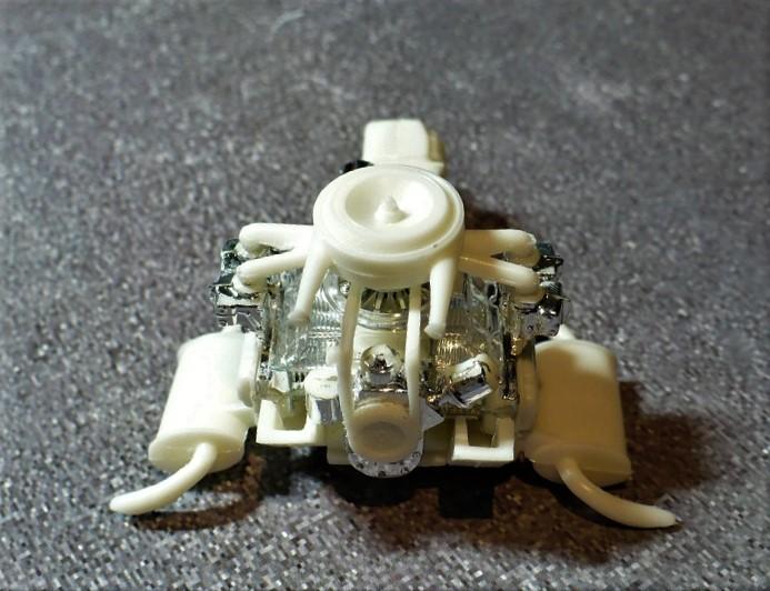

It is the latest release from Round 2 and I was not really impressed. There was so much flash and massive mold lines it was just a vagally Corvair shaped chunk of styrene. I was so shocked that I didn't even think to take pictures but the mold seems on the rear of the body were so big it looked like a '59 caddy! It was disappointing but of course not insurmountable.

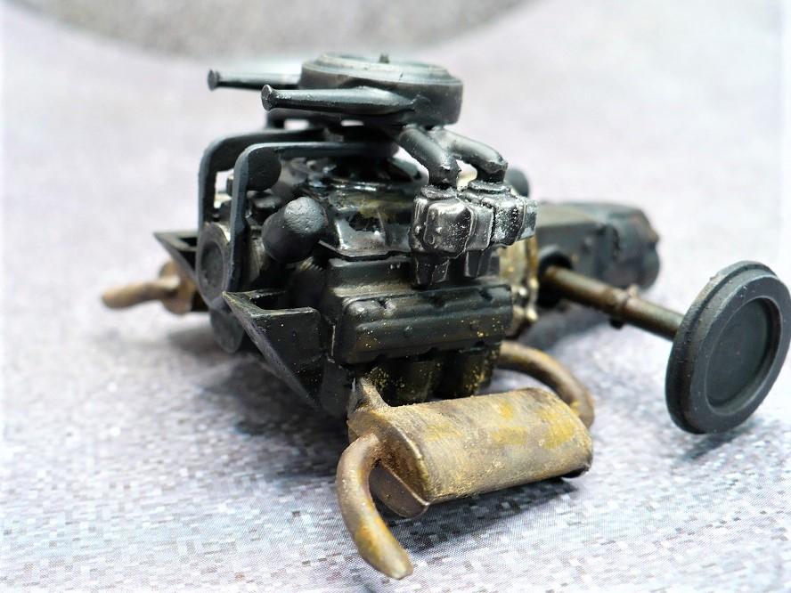

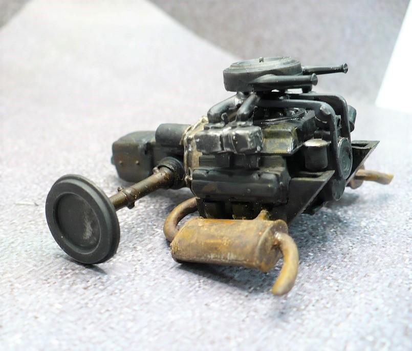

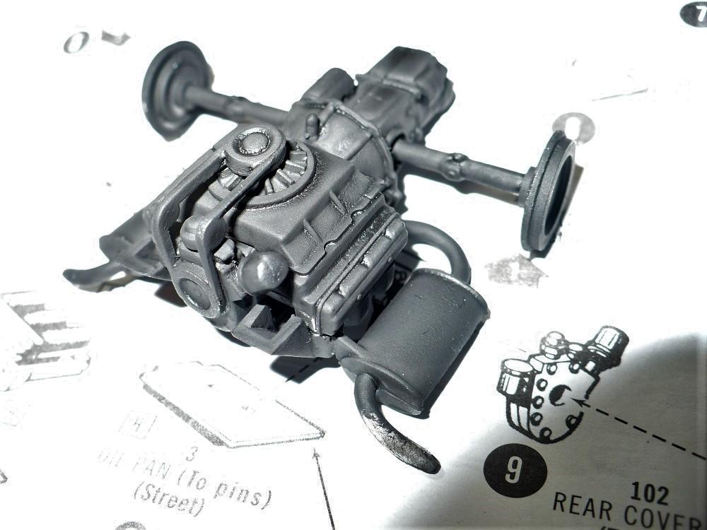

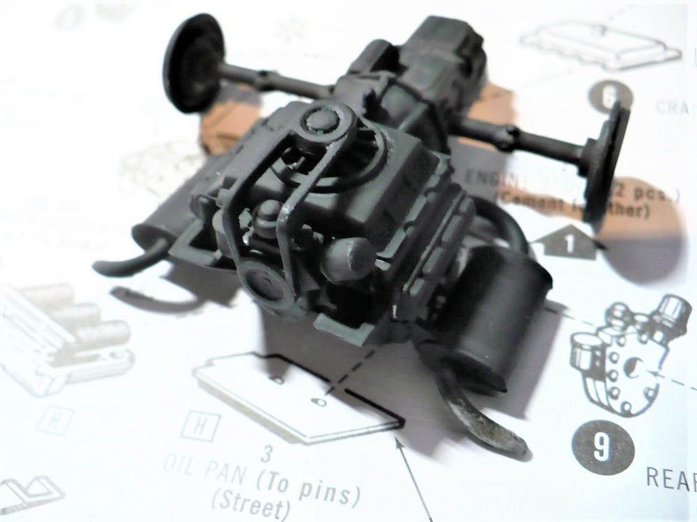

As always I started on the engine. It required a great deal of cleanup as well but went together nicely. This will be another rather worn and well used build as mine was 14 years old and all original when I got it.
Without flash
With flash

Hello!
I'm looking forward to another build in this series!
It's interesting to see details of a rear-engined car. That "bent" belt drive looks really weird, for example.
You might want to take care of that mold line on one of the mufflers - that cool weathering really brings it out...
Anyhow, looking forward to more progress on this one - good luck with it and have a ncie day

I got realy good at putting that belt back on at the side of the road. It didn't like the heat and no matter how it was adjusted it would throw at random times. Being an air cooled engine you had to pull over imeaditly or risk overheating very very quickly.
That mold line is almost invisible in real life and it is just the magnifying aspects of the camera that make it stand out so bad. Even then once in the car you won't be able to see the ends of the mufflers anyway. Those engines are really crammed in there.

Very interesting engine!

They are the only North American designed boxer engines (no they did not come from Porsche like urban legend likes to state.) and the turbo versions were the first turbo production cars anywhere. They were way ahead of their time and although much maligned were a very good engine.

That odd fan belt arrangement caught my eye right away!  What were the engineers thinking when they thought that one up?  I bet the Germans would have made a complex gearbox to drive the fan.  Maybe an electric motor would have been better.  But to rely on a motor that runs all the time to cool the engine would have made the Corvair...unreliable at any speed.  Stick out tongue

Porsche and VW went with a vertical fan but that of course increases height in the rear. The horizontal fan gave loads of space to keep more of the North American design lines in place. It actually worked pretty well but mine was old and worn. In hindsight and with 40 more years of car experience I believe that most of my issues were likely due to worn out pully bearings not the actual design. I didn't have a whole lot of money so I pulled down the engine enough to get it running well but the auxiliary components remained original. The beauty of these engines was that they were dirt simple to just drop out of the car, work on and pop back in. No rad, coolant lines, pollution conrol lines, A/C crap, etc just some wire, a fuel line and 6 bolts. Could have the engine out in under 20 minutes.

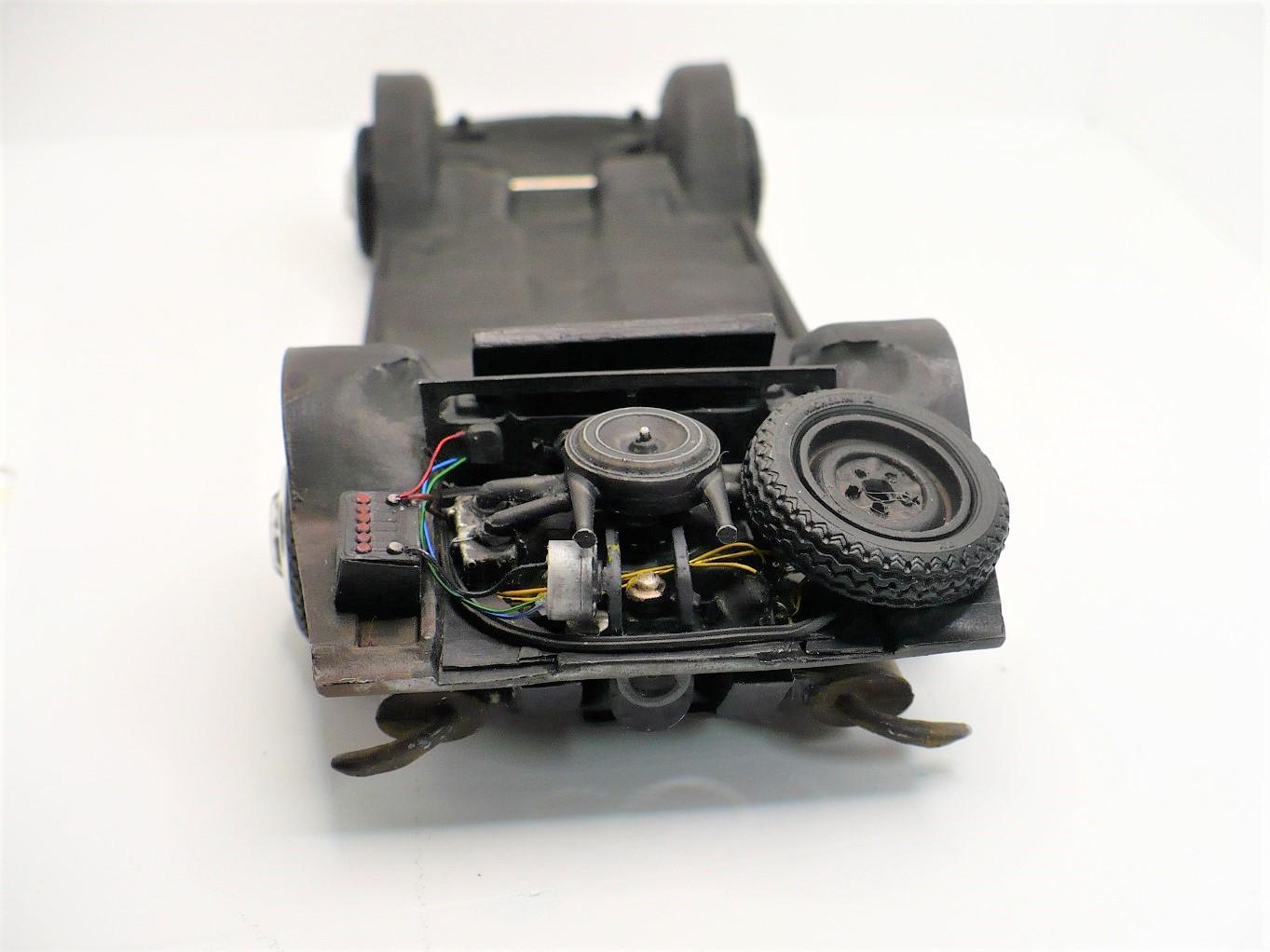

Well this was supposed to be a nice simple out of the box build but since the only other thing for the engine bay (as above)  from the kit is a battery I have some work to do!

Curious place for a spare tire.

I presume it was for weight distribution since the A/C cars had them in the front.
It makes far more sense really.
Mind you there was no space left if you had A/C!
They had to get really inventive with a mount for the rear.
Even the turbo cars had them in the rear. They had to factory dent the housing to get them to fit!

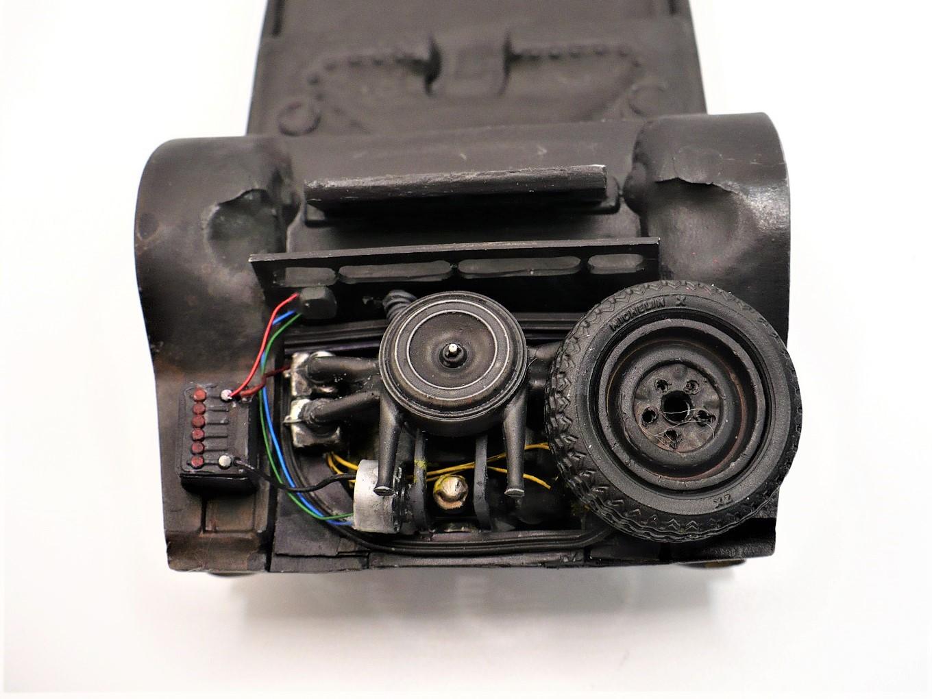

Posted by Tcoat on Saturday, March 4, 2023 1:02 AM

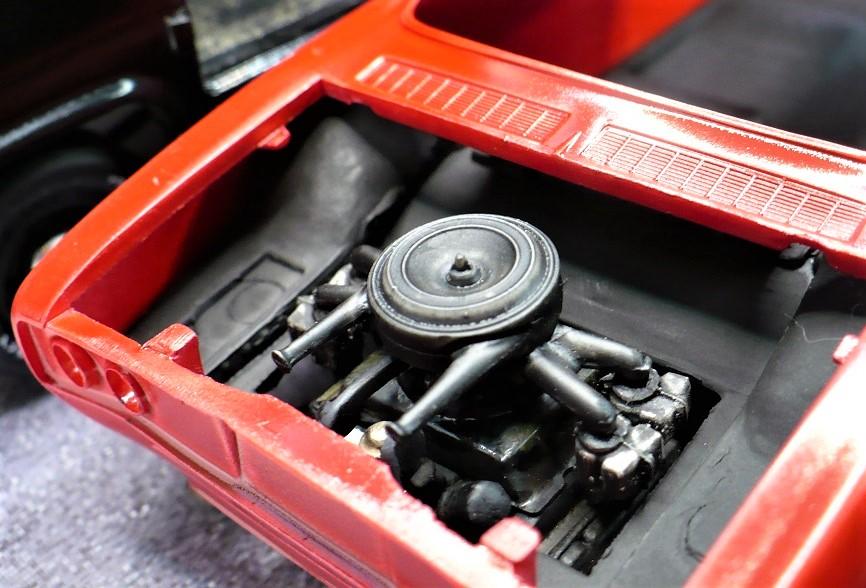

Not 100% accurate but busied it up. Will get dirtied up a bit more when body on.
Proper fire wall made.
Heater duct is a piece of a header with wire wrapped around it for "pleats"
Shrouds all around so can see through.
Rubber shroud gaskets are screen spline split into smaller strips.
Long skinny stock 1966 battery swapped for normal one.
Spare tire from spares box parts crammed in.
Wires are... well wires.

Now that's some nice detailling!

Wow - engine looks fantastic!

Thanks! Can't see about 60% of it when the body goes on but looks better than the empty void the kit provided.

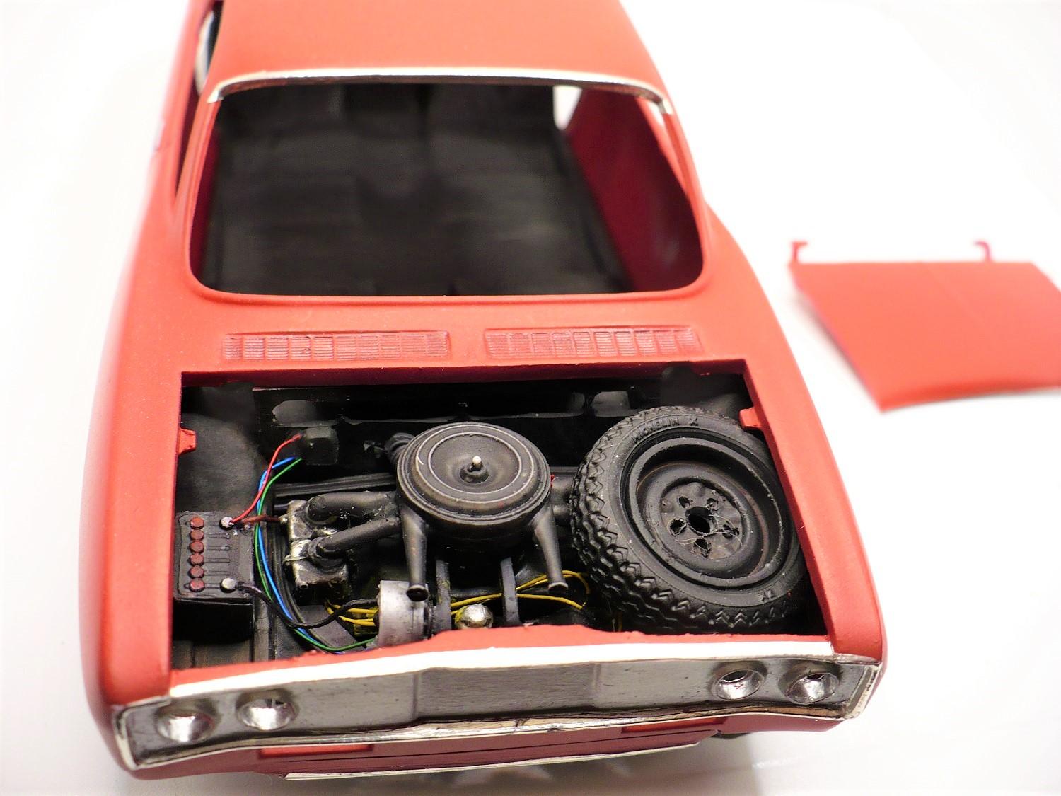

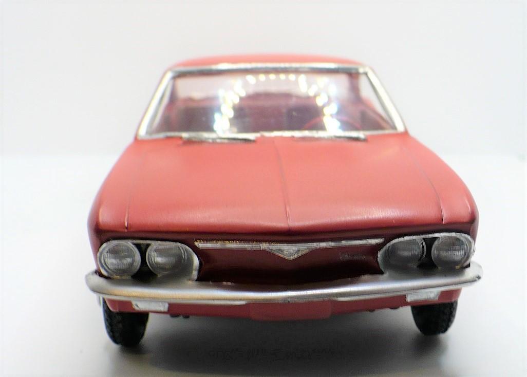

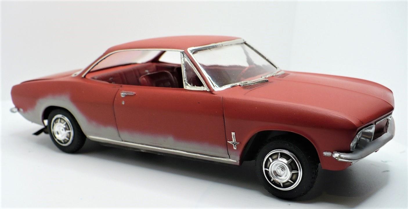

Done. Still needs a mirror but I don't have a suitable one right now so that will come later but still calling it done.
The dull faded paint is done by painting Testers dark gloss red then misting a very light coat coat of Tamiya flat red over it. The slight grunge is from digging out a really worn and dirty sanding stick and rubbing it down to take some of the flatness off and leave some spots behind. It was an experiment that I think worked out well because the resulting finish is exactly what I was after.
The rather rough looking BMF doesn't look like that on the actual model of course. It is the magnifying effect of the camera. You can really see the existing yet subtle dirty sanding stick results on the quarter panel.
The silver rear looks just like the brushed aluminum panel on the actual model
If you look really close you will see that the drivers side reverse light is missing the white lens. I never did find a replacement for the real thing back then but no doubt now they are all over Ebay.
Well there it is. The real thing wasn't pretty but it was cheap and fun.
