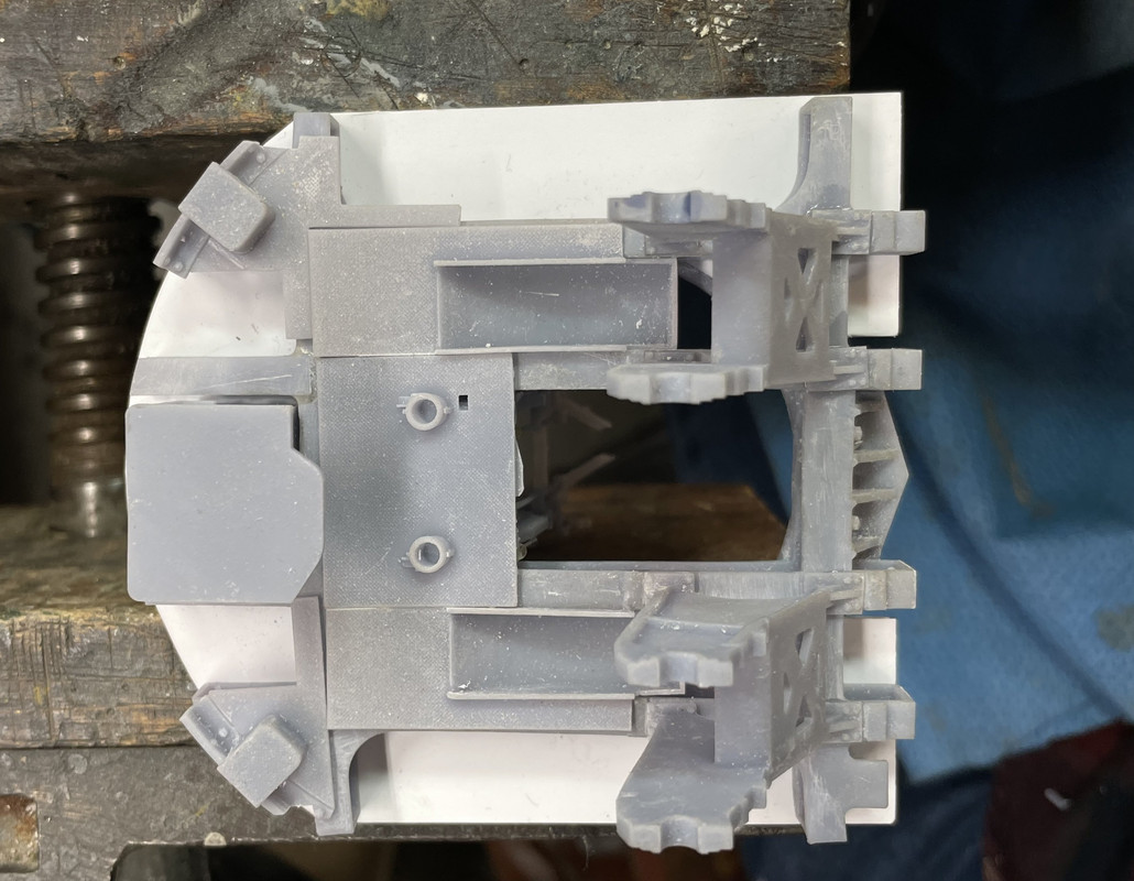

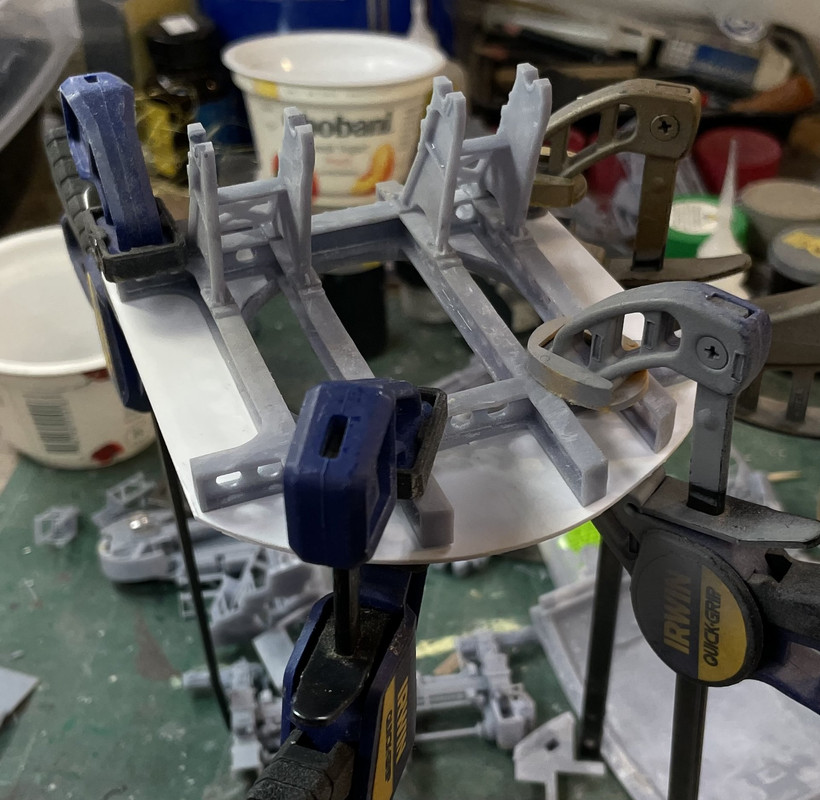

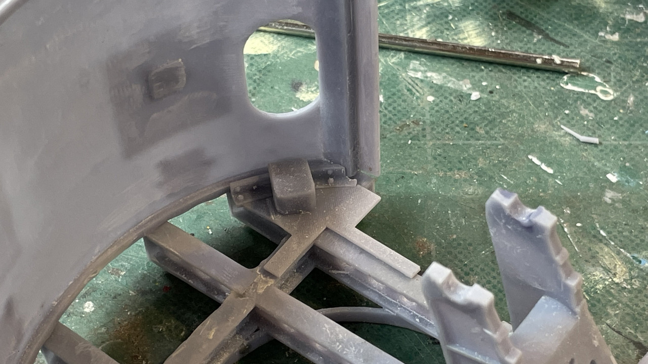

The assembly process has officially begun. I glued the gun house base plate to the underframe. Styrene to UV rensin? Only with CA or epoxy. UV resin is impervious to most common plastic solvent.
The print package was the flooring pieces. Ryan sent me photos of all the floor plates in the gun house and I was able to reproduce them with reasonable fidelity. I was struggling with the diamond plate. I had downloaded a piece of this from the 3D Warehouse. The artist didn't group the pattern separate from the substrate so when I attempted to trim or enlarge the sample to fit my various piece shapes, I had to deal with the substrate disappearing, reversing faces, or just being a pain in the butt. Finally, I decided to separate the diamond patterns and group them. This allowed me to shape the substrate, which is quite easy, and then drop the diamonds onto the surface. Since they are their own group, I was able to erase them in one tenth the time it was taking before.
I designed he little box steps at the rear hatch openings to assemble with the curved angle brackets.
Here's where they fit nesltled into the rear curved wall.
I assembled the floor pieces on the frame for fit and understnading the assembly process.

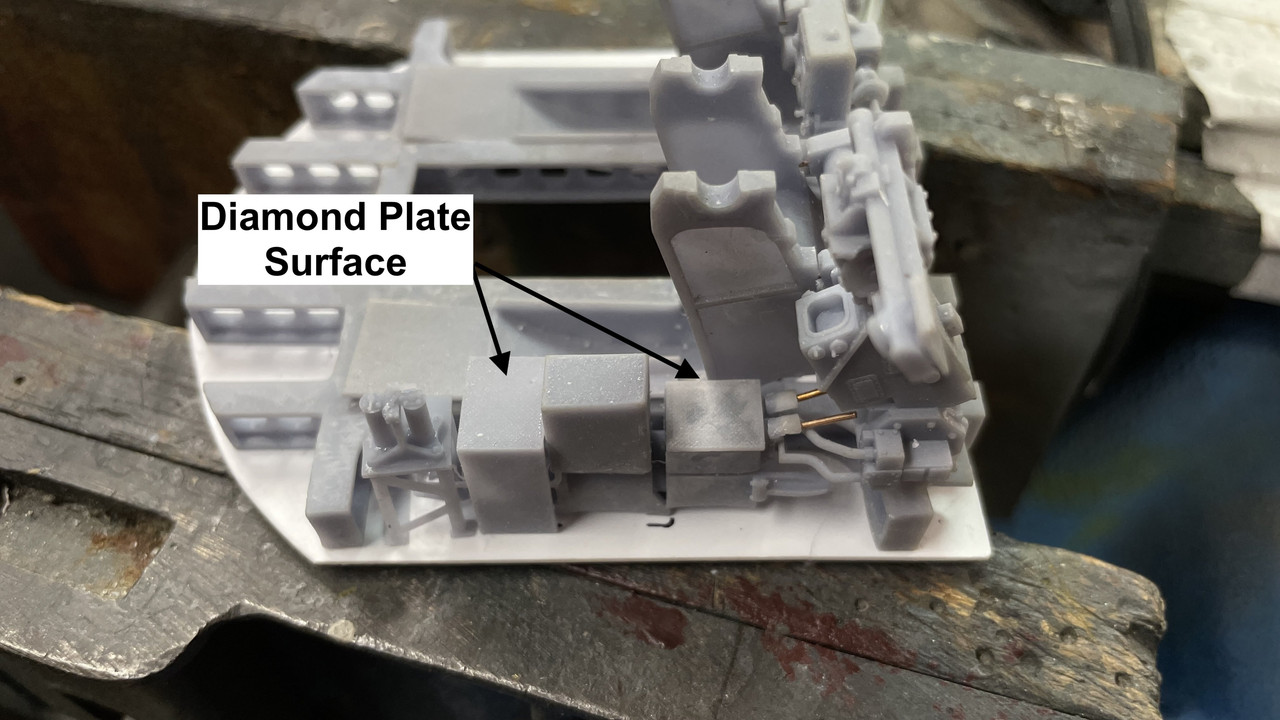

With the base plate in I'm able to test fit and locate all the gun house details starting with the elevation and training pump systems. The training pump was easy since it just has to nestle up against the piping I printed that come out of the b-end hydraulic motor. I marked the base, but when this is painted, those will disappear so I'll probably go back and make some punch marks.
I then test fit the small, diamond-plated flooring pieces.
I did the same for the pointer's side. This was a bit more complicated since the spacing is fixed by the very small floor piece that spans between the pointer regulator, where it sits on a built-in ledge, and the a-end of the pump system. I had to add a small piece of angle to support the aft end of the floor.

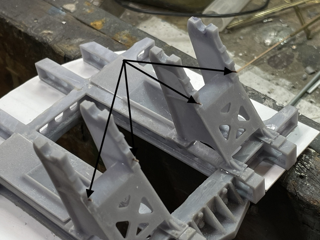

The angle:
And the floor piece. It was very hard to see just how this little bit of floor was attached in the real thing. Ryan's photos only show it from above and all the drawings don't detail it sufficiently. I had to fake it.

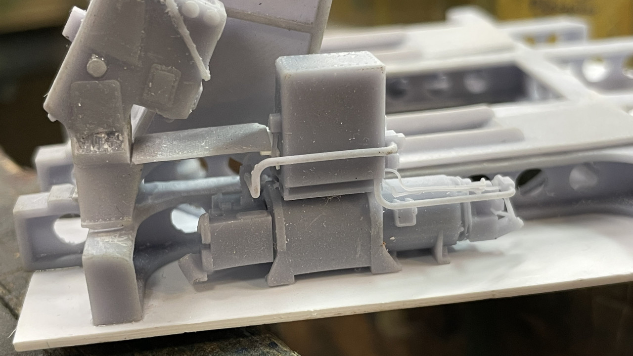

There are hydraulic lines eminating from the a-end of the pump which I will probably add old-school with solder wire.
The entire mechanism assembly needed some possible positioning on the gun mounts. i chose to use 0.022" phos-bronze wire. I broke way too many carbide drills doing this.
It took some trial and error to get the pin holes in the two pieces so they'd line up. I then drilled and pinned the mounting for the fuze setting regulator. This simple job almost went completely south. I kept breaking the 0.03 2" drills doing this simple operation. I ended up having to drill three diffferent holes to get one without a piece of broken carbide in it.
Fitted, but not glued. This will be glued after the gun trunnion cap is installed on that side.

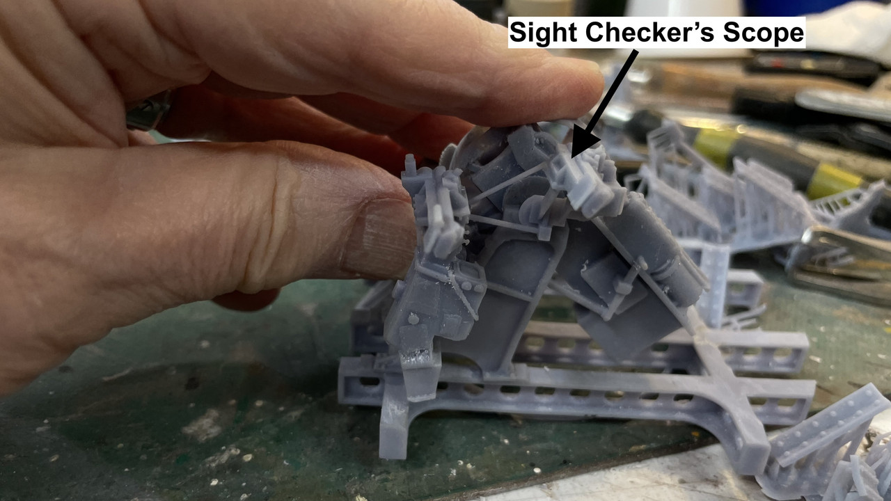

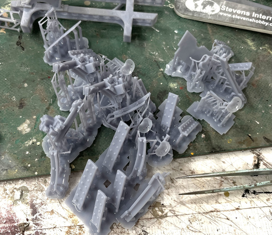

I drew and printed the sight checker's telescope. This station is only used during trainining exercises to evaluate the trainer and pointer proficiency. I made a lug on the mounting point that serves as a trunnion pin on that side. This solved a problem for me.
While there's a just a couple of details left to do for the gun house, I'm starting on the upper handling room. I first tried to fit the entire wall structure as a single part, but as you can see, the setup on the printer was not ideal. Way too many supports for my liking.
I have a friend with a bigger printer and talked to him about it, but I don't have his printer model available on my slicer. So I went to plan B. Separte the four wall maintaining the nice curved corners. It's those corners that dissuaded me from doing it out of styrene sheet. This permits me to leave on wall open if that's the way I want to approch the cutaway. I did this same scheme when producing the little n-gauge buildings for the exhibition layout. They're printing now and will finish in a couple of hours. Notice, no supports on cosmetic surfaces. Just the way I like it.
Happy to report that the print came out perfect, including the replacement bicycle seat assembly. It's in the ultrasonice cleaner now, and I'll finish them up tomorrow.

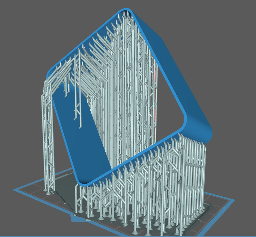

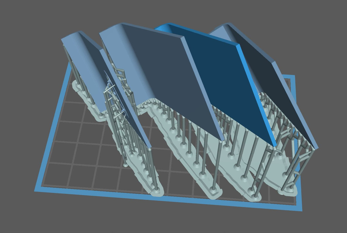

With the amazing resolution the printer is finally giving me, I decided to redraw the main gun carriages and re-print. I was very unhappy with the malformed loading trough, the broken piping that I had to replace with metal, and the broken and mishapen controls. It took a couple of attempts (as usual) to get a really good print. I'm getting pretty good at predicting when and how big supports need to go, but I still miss a few. I did that in this case. So I did one print in the afternoon and then another repaired drawing version overnight.
Here's a comparison of the early one done months ago (before the printer adjustment) and the new ones.
Here are looks down the part showing the that critical loading trough. Note: I have not done final finishing on these parts. The nubs you see will be gone before printing. I'm making one gun with the breach open and the other closed. I don't think you'll be able to see them in the finished model.
and the old one. In the first iteration the trough was filled with errantly formed resin. I attempted to grind it out and restore the concave apperance. It was barely acceptable. Notice also that I had to reattach the operating lever on the left and reform the ball end out of Bondic. The new ones have perfectly formed levers.
I also redrew and print the floor trough with the curved space for the gun elevation so it would fit acccuately in the between-frame space.
The gun house work is almost complete. I have to do some more work on floors and platforms, and build the sight checkers telescope and mount. I can then start painting and assembling it. I need more info on the ready service room that lies below. I don't know the floor plan and need direction on what walls get the ammo racks, the circuit boxes, and the access hatch. I also need to know exactly where the upper ends of the powder and projectile hoists lie in the actual space. I had pictures Ryan took of these things, but didn't specify just how they're laid out.
With the new exposure setting on my printer, the supports are much stronger (as well as other tiny details) so on these complex parts, my routine is use the "auto-supports" feature with light supports on the entire part. I then go back and selectively delete light supports in places that would experience higher lifting forces and replace them with Heavy supports. In the past I couldn't trust the light supports. They would break prematurely. With the 3.1 second exposure, they are quite strong and do not break. This really improves both the print success and facilitates cleanup. Most of them can simply be pulled off. I cut them carefully when they're attached to delicate aspects such as levers and handwheels.

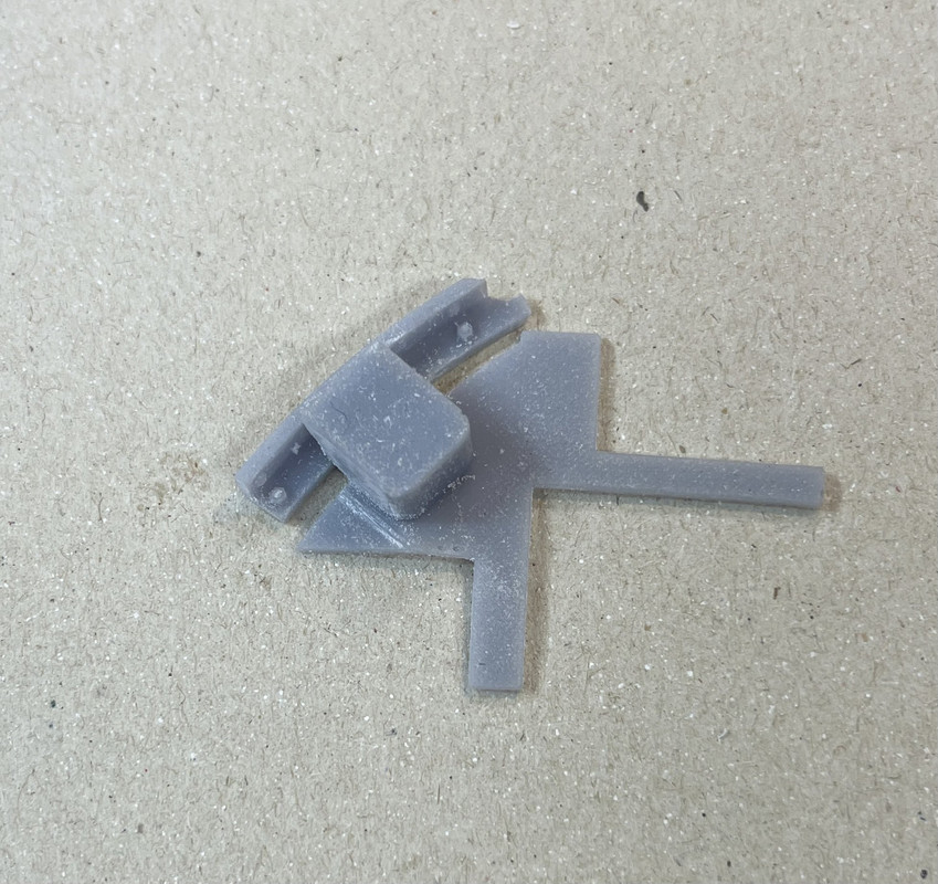

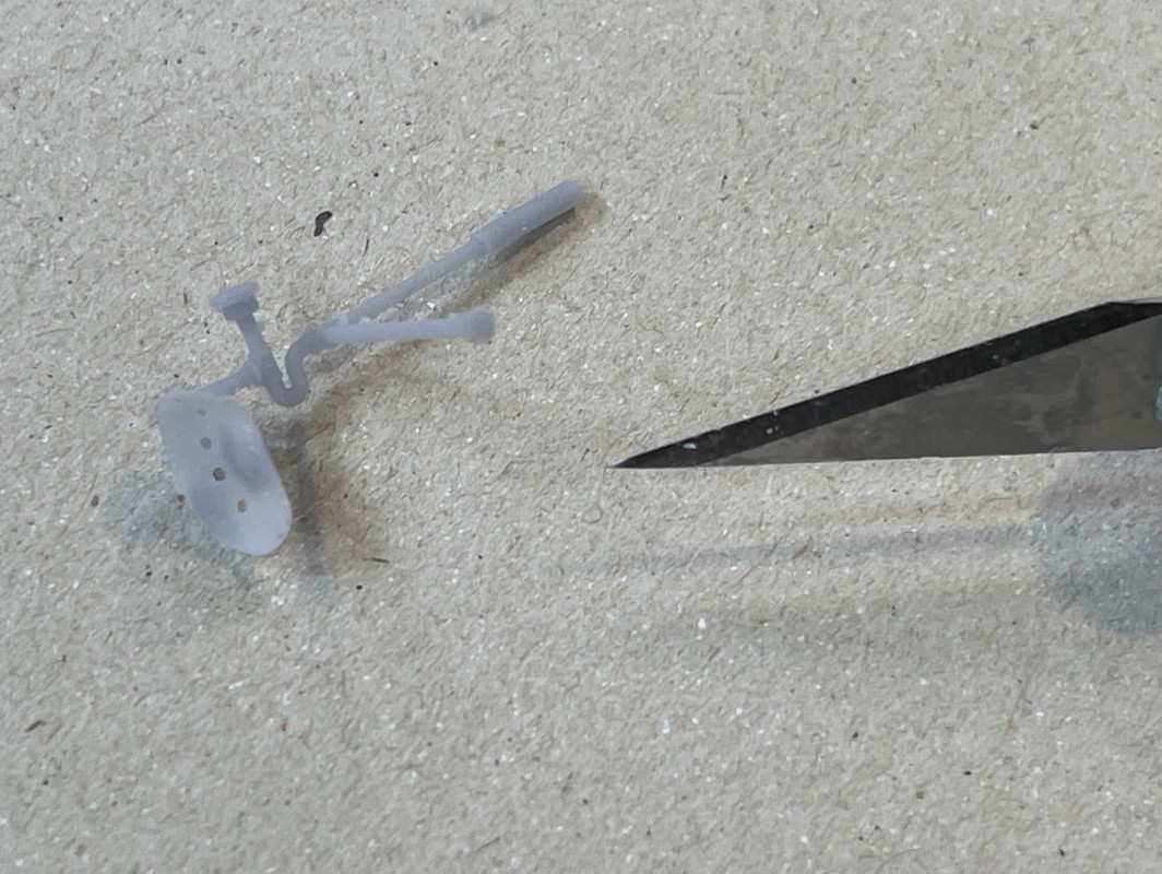

I was able to get good parts for the projectile hoist after three tries. The first, for some reason, came out 20% over-sized. Something occurred when I made the scaling in the slicer. I don't think it was loading the wrong factor (2.08%), but rather was my entry. I may have double-clutched and got an erroneous value.
It was a shame. It was a pretty nice part.
The powder hoist portion was decent, but the control links were too fine being close to scale size. I doubled their thickness, and also increased the floor thickness by 2X to increase its stability and make the diamond plate texture more pronounced.
The 2nd projectile print, while correctly sized, needed a lot of repair. I broke one of my cardinal rules: Scale thickness doesn't always translate well in the 3D printed 1:48 world. I made the columns prototypically hollow with the twin bores extending full length. The resulting wall thickness was so thin that it ruptured all over the place. It was actually translucent. I attempted to rebuild them with Bondic, and while structurally stronger, looked awful.
As with lots of SU projects, fixing is often more difficult than making it right the frist time. And this was no exception. Took about an hour to fill the bores. I also took the time to strengthen some other dubious connections. While doing this I also fixed a lot of drawing stuff like hidden layers that didn't do anything.

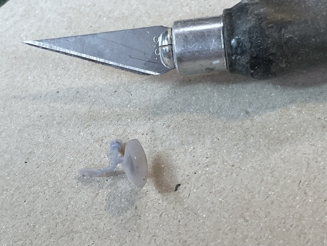

I was rewwarded with a really nice print. I only had to go back and reattached some tiny links and further strengthen the door hinges.
Get a load of those very fine pull handles compared to that #11 blade. I was impressed. I also added some mid-run supports for the long-run link rods so they would have a better chance for printing and after-printing survival.

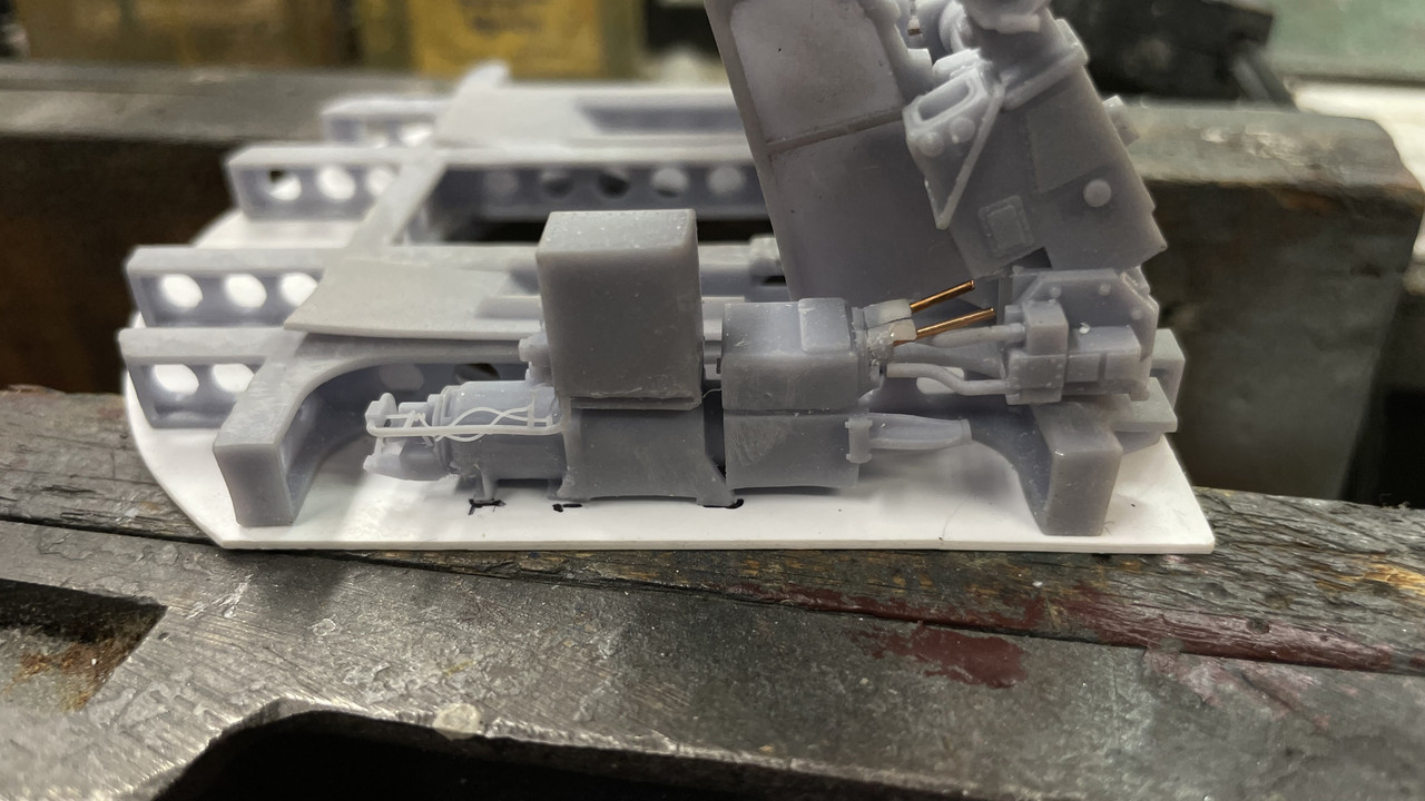

I had to notch the floor at the front corners to nestle over the gun mount's rear feet. I was worried that after all this work I couldn't install them, but if I moved the powder hoist as far aft as it would go, carefully inserting the projectile hoist sideways between the frame rails, I was able to lower it and twist it into position. I did have to relieve the width a bit at the cross-girders to make it a slip fit.
5IP Hoist Complete Test 3.jpgThis was, without a doubt, the most complex parts I ever produced, and is the apex of complexity on this model. With it successfully done, I can breathe a bit easier.

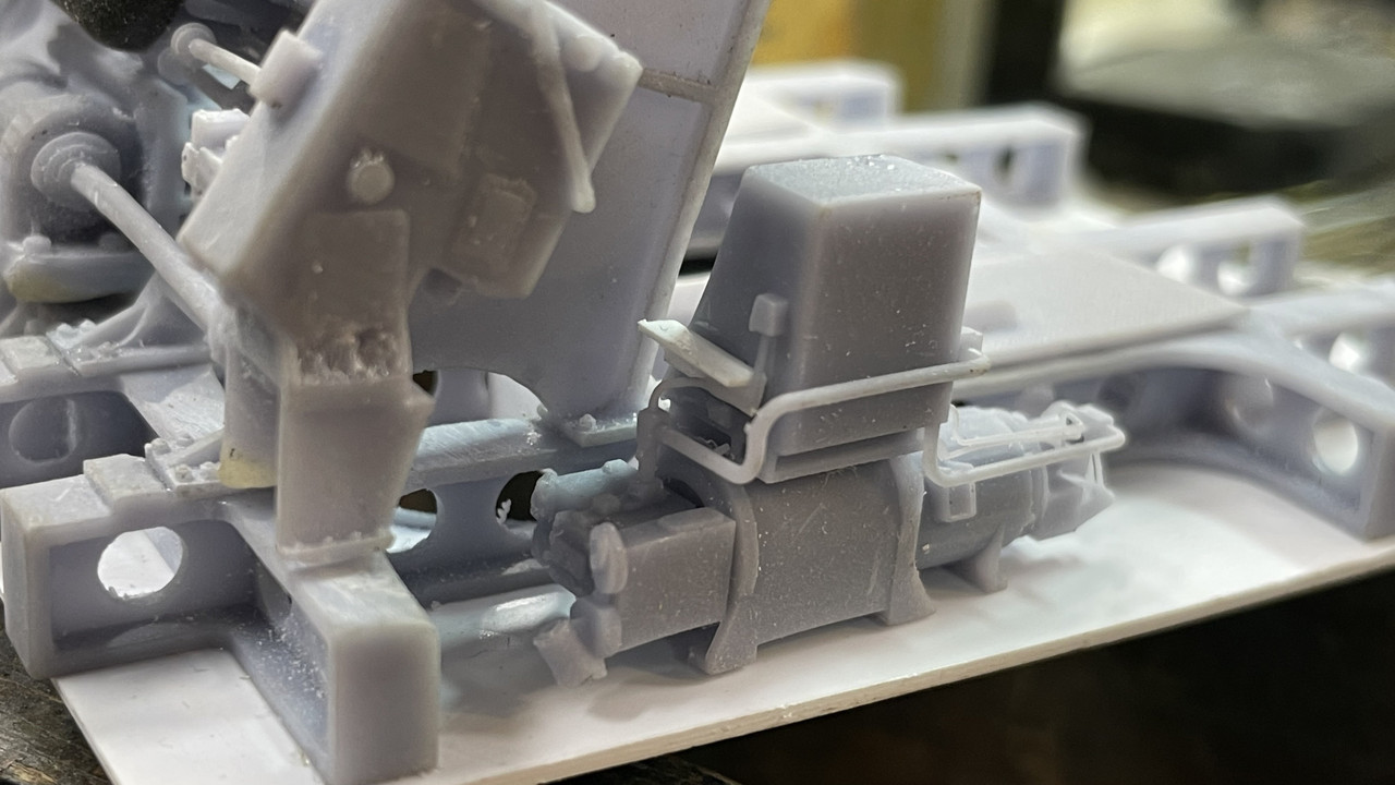

I drew and printed the floor pans that sit between the frame rails under each gun. These are sheet metal affairs in the real deal, and have a curved floor that follows the arc of the gun. I made perfect prints. Perfect, but for the fact that they were about 5 scale inches too wide! I used the drawing of the frame rails for sizing assuming that my printed part was the same. For some reason, it is not. I will redraw and reprint. They weren't the only thing that was too wide for the frames rails. The gun itself was too wide to drop down between the rails. More about this later.
The oil filters and pedestal were easy to draw and print. I drew the tiny hand screws on their caps, not knowing if they'd survive printing and support removal, They did!5IP Gun House Auxiliaries 1.jpg
I added more stuff and took this image. Starting to get interesting!

I gave up on the idea of printing this beast in one piece. Instead I designed the two pieces so they will index together during assembly. I did this by adding some more structural steel at the bottom tying the two powder hoists to the central column. While this is not prototypical, I took artistic license to make the model work.
I also split the floor panels and added a lip to align and give purchase to the asembly joint.
Here's the mess of supports needed to set it up for printing.
It's on the printer now and will be done after 10pm. I'll know then whether it's successful or not. Then I'll have to figure out how to remove all those supports without wrecking anything. Wish me luck.
This was the last of the really complicated parts on the project. The rest is downhill.

I found out that the fuze setter regulator that I modeled last week was an older version that was NOT on the Iowas. At first I thought, "Who's going to notice", but then my AMS took over and I had to draw and print a correct one. Ryan appreciates this.
It printed nicely. I also printed the opposite hand versions of the optics shields so I can pick either open or closed on both sides of the gun shield. And I printed some scale 5" projectiles. I'm going to need a bunch of these since they'll appear in the gun, the hoist the ready service room and the magazine.

It was 11 days ago when I put this complex sighting system on the printer. Since then I did five different runs. Each had it share of problems from total failures when my build plate has lost its holding power, to failures due to mistakes in my design or drawing execution. Today I was able to get a fully usable part. I had to make some minor fixes using Bondic, but all in all it will do well. Meanwhile, I had designed and drew the Sight Setter's Regulator and incorporated it into the part's design and printed it as an integral unit. The Sight Setter's Regulator adjusts the two telescope prisms so they match the aiming data sent down by the gun directors. In normal operations all of these settings would directly operate the guns, but everything has a manual backup.
This is viewing from the turret front. The front armor shield normally hides all this, but I will cut it away so some of it will be visible. It's pretty cool in its complexity.
And the rear view that will be seen from the turret's interior.
After doing a trial fit I was rewarded with a pretty good result.
And the interior view.

And how it's going to go on the printer. Lots of corners and curves that needed specific supports. The flanks of some of the tiny bolt heads show up as needing supports, but I chose to not attempt it. The support removal would destroy the detail anyway so we'll just see how it all turns out.
I'm going to put it on the printer tomorrow.

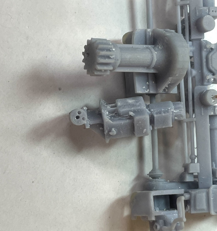

My first prints of the elevation and training pump systems was okay, but a couple of details didn't form and it bugged me. Here's the first attempt.
You probably can't find the errors, but I know they were there. I tried them on to see how they looked sitting in the framing. And they looked swell.
When I went back and evaluated the support scheme, I found that I misplaced the tiny support on the upper side of the detail, not the bottom-facing apex. This caused the detail to not form correctly until the build reached where the support was. This is support skills 101: the support goes at the bottom-most point what would start to form and create an island. There's a moving line in the slicer that helps you identify this contact point. In this case, I missed it a bit.
When I repositioned the errant supports I got a really nice print. I also moved some supports or made them smaller where they were difficult to remove without damaging the model.
Those piping details are very, very fine. The phos-bronze wire is showing where the links are going to connect to the regulating pedestal. They will not be this long. I pre-"drilled" the holes in the drawing so I could easily open them up with a 0.032" drill.
The new setting is amazing. It's like learning to 3D print all over again. I'm also reprinting the foot rungs since the new setting will make a truer and stronger part, plus a less warped base that I'm using as a drill jig.

The Elevation Pump/Motor Hydraulic System shares the same motor/gear box/reservoir with the Training System. The output end is completely different and the units are mirror-images of each other. But having successfully crafted the one, drawing the other went quickly. Both just came off the printer and, with the new exposure settings, the detail is exceptional and all the piping is intact and tough. I'm very happy with these results and it tells me that anything I can draw for this project with print as I want it.
I'm now wrestling with the human interface portion of these systems, the pointer's and trainer's regulators. These, like the rest of this job, are not easy to visualize or draw. All the pictures I have are persepective images and therefore, I can draw directly on them. There are very few surfaces that are parallel to the SketchUp axes, and many of the corners and junctions are rounded/curved. None of this makes it an easy SU drawing project, but I will persist. Ryan Syzmanski is enjoying seeing all these components separated from the complexity of the insides of the turret.
I'll post the finished parts tomorrow.

I designed the Training Gear hydraulic plant. This sits down between the girders on the gun house's right side behind the Trainer's seat and regulator. Luckily this one is drawn in profile in one of the cross-section images I found so I could get the profiles down. I've scaled these drawings so they are representing correct lateral dimensions.
There are two output shafts that extend out of the end and I probably will make these out of correctly sized wire. It was gratified after finishing the drawing that it fit perfectly in the space it was supposed to. I have an add-on that facilitates making those neat curved edges. Also, SU is pretty easy to draw complicated pipe runs once you know what you're doing with connecting lines and adding curves to them.
Here it is dropped into position.
Next up will be to design this units hydraulic counterpart, the Elevation Gear Hydraulic Plant.
As in the big gun's turret, all the systems are driven by hydraulic motors with the pressure generated in a remote motor/pump setup. In the case of the big gun, the motor/pump (A-end) was physically remote from the hydraulic motor (B-end), but in the case of this smaller turret complex, the motor/pump was directly in line with it's b-end hydraulic motor.
With my newly refined printer setup, I have no doubt that all that delicate piping will render. It should look pretty good.
