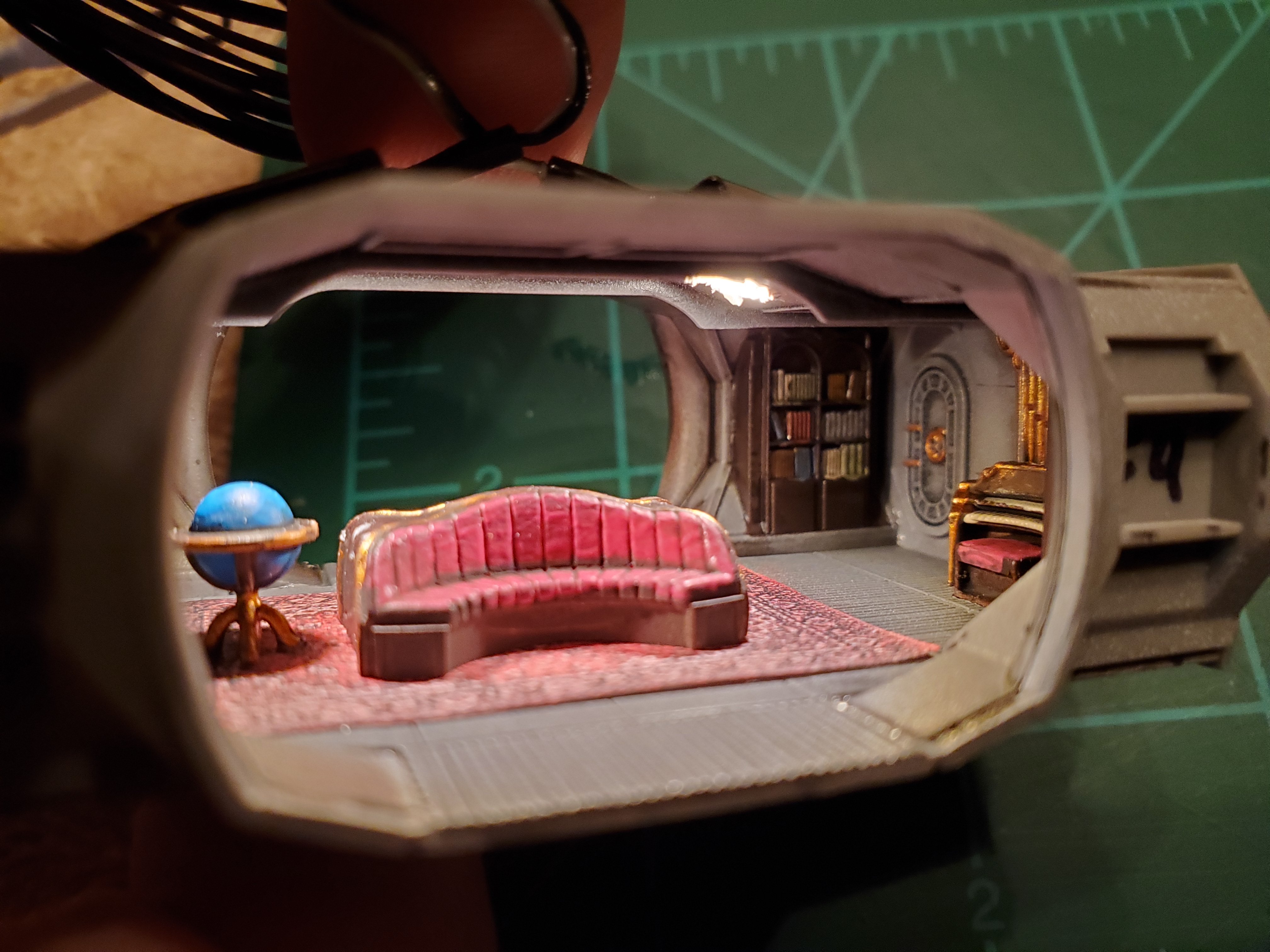

Work in progress. My first attempt at lighting a kit.

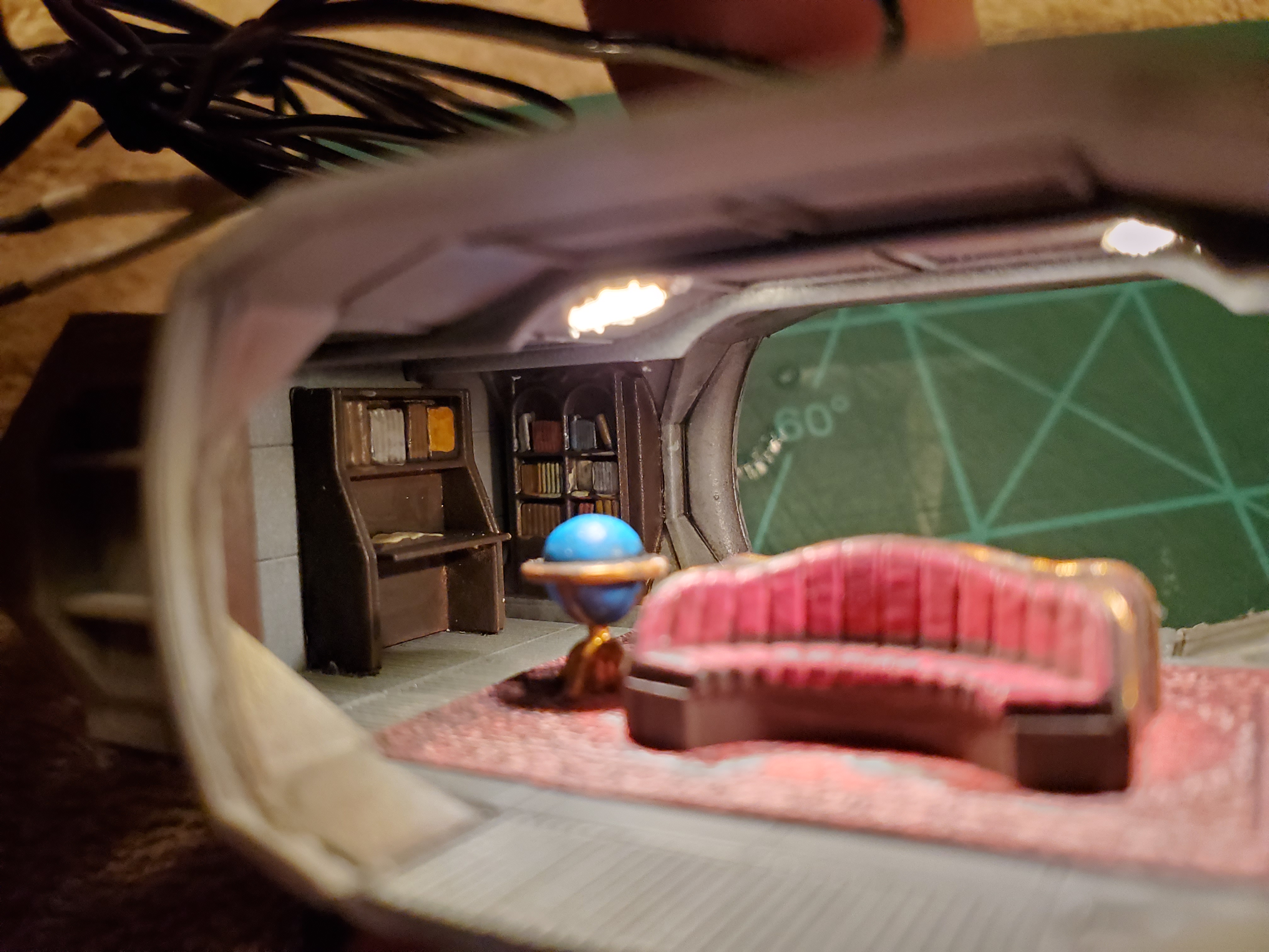

I’ve begun building the Pegasus model of the submarine Nautilus of 20,000 Leagues Under the Sea fame, and have encountered a problem, not with the model itself but with some “kitbashing” of the model.
Early in this thread, I noticed the rug which the OP had added to the submarine’s saloon, which features a double couch, world globe, organ, desk, and bookcases. What a great idea, I thought! I went searching for a good rug image, found one, and resized it. Here's what it should look like with the rug, couch, and globe in place:
 I tried to use Bare-Metal Foil adhesive to stick the rug onto the flooring. I had never used that adhesive (haven’t yet been brave enough to use the foil itself), but I brushed on a thin coat, which was soon tacky, placed the rug in the correct position on the saloon’s flooring, and rubbed it down with a soft cloth, as suggested on the bottle of adhesive. An hour later or so, I picked up the assembly to look at it, and the rug just fell off! Next I tried a thin coast of Elmer’s white glue. Same darn thing happened! No adhesion whatsoever!
The problem, in part, may be the “boards” of the floor, which are separated by grooves. Perhaps the boards are too narrow for the glue to adhere to. Or maybe the “boards” have nothing to do with it. I assume that the photo paper is backed by a thin film of plastic. Could that be the problem?
In any event, I’d appreciate some advice about adhesives which may work. I’ve considered a thicker coat of Elmer’s white glue, or a thin coat of Gorilla Glue, or even a layer of Tamiya clear acrylic. Whatever I use, I don’t want the rug to come loose after the submarine is all buttoned up.
Bob

Posted by Gamera on Thursday, January 27, 2022 11:48 AM
Bob: That looks sooooooo cool!
I'd think the Gorilla Glue should hold it. My go to ultimate glue though is two-part epoxy. Once it's cemented on with that you need a pair of pliers to rip it back off.

Posted by Bobstamp on Thursday, January 27, 2022 6:25 PM
Thank you for your suggestion, Gamera. I decided to try Gorilla Glue and it seems to have worked well. I had decided to look for a better rug, one that's lighter in tone, and even more attractive to my mind.
The reviews of the Pegasus Nautilus model that I've read have commented that it's hard to see the interior through the large windows on each side of the vessel, so I figured that a lighter rug would work a bit better. I considered buying a set of LED lights for the model, but I don't think I'm ready to build in that degree of detail.

I'm almost finished with the saloon of my Pegasus Nautilus model, and have decided that it would be nice to add enough lighting to at least make it visible once the model is buttoned up. See the first post in this thread for the OP's lighting.
I've seen various web pages and build reviews, including some that discuss adding multiple LEDs, but I'd like just one to provide a bit of illumination to reveal the details of bookshelves, watertight doors, a rug, a couch, etc. that have taken me hours and hours to do. Can someone comment on the feasibility of adding just one simple LED, and where the lighting products can be purchased?

Posted by Bobstamp on Sunday, March 6, 2022 10:41 PM
I am very pleased with the LED lights offered by Evan Designs, as well as their great customer service.
Yesterday, I temporarily assembled the Nautilus's saloon, with the LED lights affixed in holes I drilled in the ceiling. It looked great!
I pondered one problem for several days. It wouldn't work to have the lights just shine straight down through holes. I needed globes of some sort to diffuse the light and hit on a great solution, a foil packet for over-the-counter meds, like this:
I can use the pills, which are nearly identical to prescription pills I already take. I carefully cut away the plastic "globes," sprayed the inside of a couple of them with white primer, and glued them with Testor's window maker glue. Voila!
