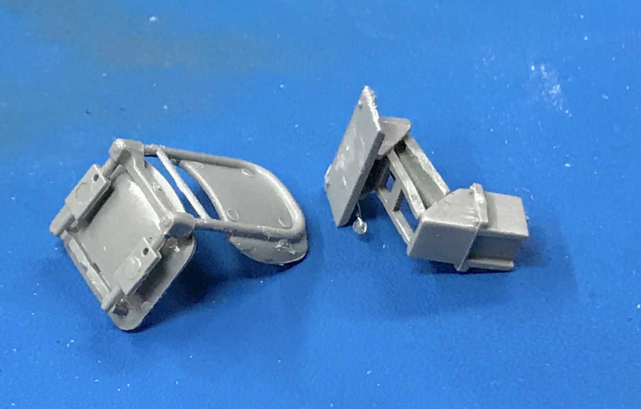

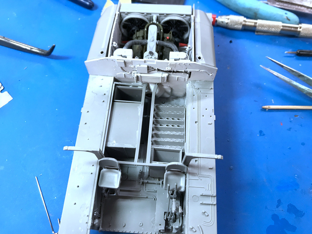

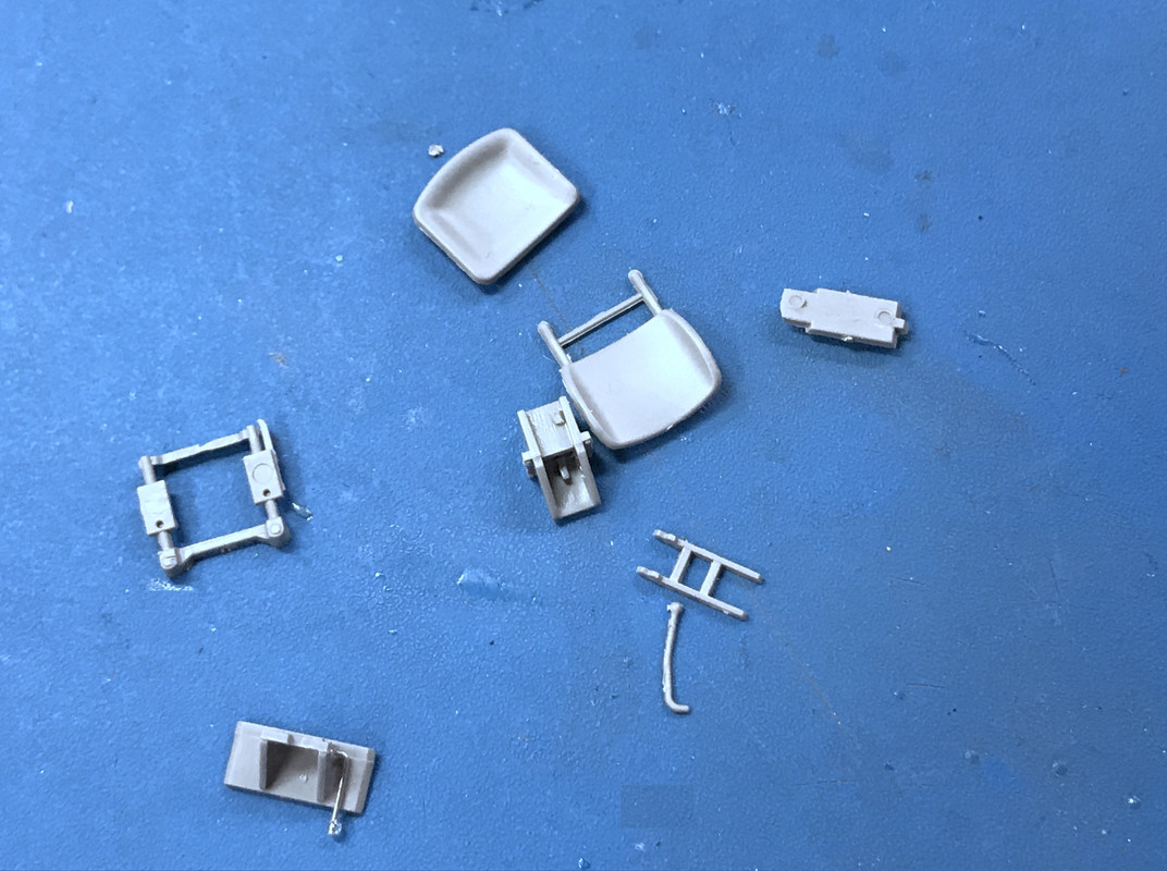

Continued building the interior with the Driver and Asst. Driver's seats. As per Ryefield's M.O., each seat was a complex assembly in itself with multiple little and sometimes ambiguous partrs. Notice that I subsitituted some guitar string with a Bondic end for the tiny, thin plastic seat adjusting lever.
You assemble the parallelogram lift mechanism first which insludes some mock suspension springs molded into the plastic. And then you build the seat and connect the two. I drilled the mounting spots for the seat back to make the hole deeper and more pronounced. Remember when I commented about how small the alignment pins were? Just look at the two on the flat part on the right assembly that are supposed to engage in the two holes on the seat bottom. BTW: I had already opened those holes to ensure the pins find their mark. Gluing the scissor assembly to the base was a real hit-or-miss operation since there was not an apparent alignment guide.
I glued the seat in place after they had a couple of hours to set up. They are very delicate.

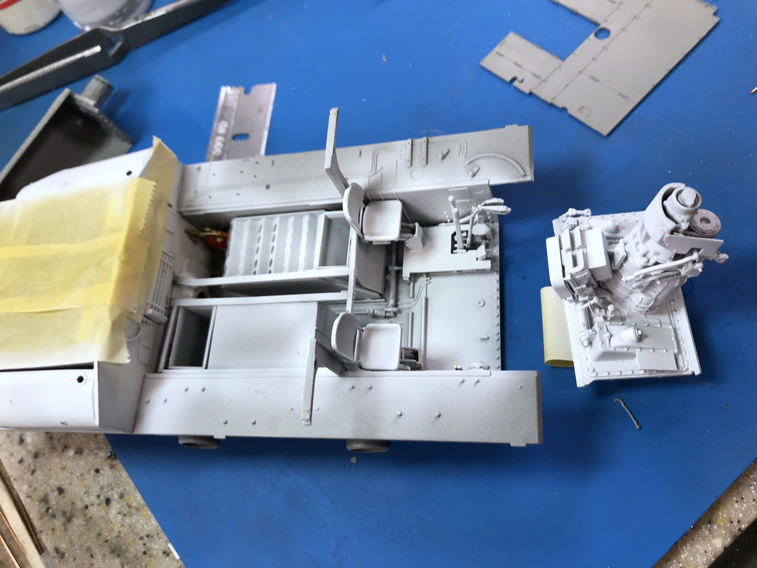

Behind the seats are other assemblies that go under the fighting floor, including the ready ammo rack, another ammo storage locker, an open-topped container, etc. Then there is a frame that supports the turret comparment subfloor. Only one of these things will be visible, the ready-ammo rack. These were sealed containers since this was the 76mm W for "wet" and they were filled with ethylene-glycol.
The frame was a very difficult piece to get settled in. One of the free ends in the back middle/right had a notch that was supposed to clip under the bar that was on the firewall, but just didn't want to go there so I clipped it off.

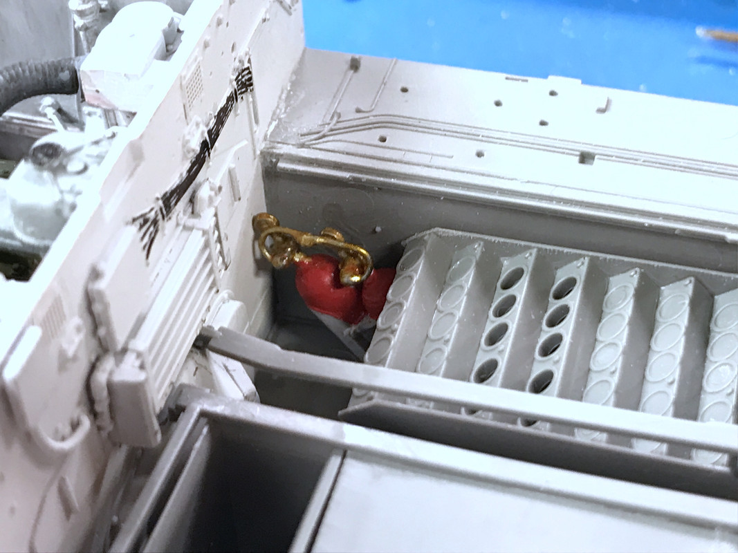

I re-installed the fire bottles in the back right corner.
Incidnetally, that pipe rack thing on the firewall is the oil cooler, not a heating radiator. The air is drawn through the cooler fighting compartment by the main engine fans and exhausted out the back. By putting the cooler on the fighting compartment side would keep it much cooler than being in the engine bay.
It was time to paint some more white. I masked the engine compartment and stuffed some foam down the area where the fire bottles were since they were finish painted. I also wrapped a reversed loop of masking tape around my finger and stuck the trans assembly to it so I could airbrush that along with the rest. I only wanted to paint the drivers comparment and the fuel tanks that were also added that are now flanking the engine bay. I didn't worry about the sponsor tops. There are ton of detail that goes there and will be painted later. I just needed to get the lower parts painted before the floor goes in.
This is all that will be seen when the floor goes in.
Do you see the fire bottles? Neither do I! Bummer! I have a choice to maybe open up the  hatches directly next to them so they're visible. It's my Sherman. I can do anything I want. The problem is that the doors that cover the ready-ammo locker, flop over the same area that the fire bottles are, thus blocking them anyway.

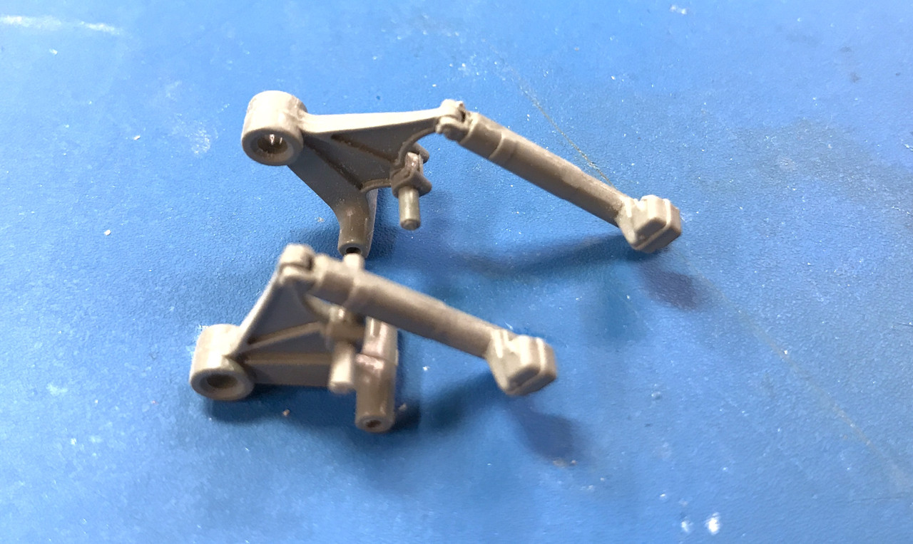

The instructions have starting to build the bogies. Lots of parts! And a bunch of silly parts. While many of you have built armor, I doubt that the bogies had this many parts. At least the ones I built didn't. The indidual swing arms have two parts.
The little round part glues to a notch on the half-arms. Took a while to clean all the parts. No flash, just sprue nubs and some parting lines.
Then comes the shock absorber that is one of the members that holds the two sides together. The shock is three parts: the main shaft and two very little other halves of the two ends. These ends are supposed to be movable if you want the suspension to articulate. I was able to successfully get all of the part 58 (6) onto the one end and captivate the arm.
The arrow shows the notch that the part goes in. The part is laying upside down in the image. BTW: that very large tool in the picture is a very fine-pointed pair of Swiss tweezers. You can only get glue in the notch so the pivot remains free. That was not easy. And the gluing surface is small. The only way I could figure to get it together was to glue the part in place, spread them enough so they could pass over the pivot holes in the shaft and then squeeze them back together. Sounds simple, but it wasn't because the solvent cement would cure too quickly so when I spread them apart to slide them over the end, the little part would fall off. It wasn't too bad one the single arm.
Here are some completed first end connections.
Things have gotten much uglier when I attempted to add the second end and connect the two sides. Again the quick drying cement was causing trouble and I even had the first ends starting to come apart while I was manipulating the parts. And then I kept flying them all over the place as they launched at of those aforementioned tweezers. I'm now down two, hopefully I'll find them, but if not I'll figure something out. My guess if this was Tamiya, they'd made the clevis as part of the shaft and make it flexible enough to spread to snap over the end. Or it could be drilled and pinned. That may not work here because the ends don't have much meat and the holes will probably break out. If worse comes to worse, i could actually make them out of brass. Where there's a will...

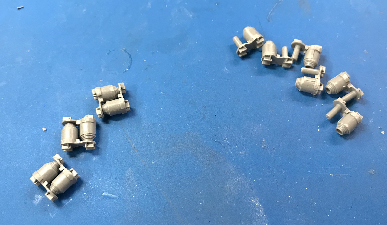

The easiest parts so far were the horizontal volute spring assemblies. These two identical parts just slip together. They don't actually expand and contract via the spring action. But they're not supposed to be glued to that cylindrical cross shaft and I'm not sure how they'll hold there. In the 1:1 Sherman, the springs are pushing outward with signifcant force.

This is how Ryefield should have engineered this suspension part. The shock should have been split down the middle with a large pin on one side and a locating hole on the other. The glue surface would be huge and it would have been very easy to keep the glue out of the hinge zone. If Tamiya would have designed it, it would have looked like this. I'm going to flatten a larger area of the shock (it's in the back) and crearte a longer more substantial piece out of styrene and then use a steel pin. It will work better.

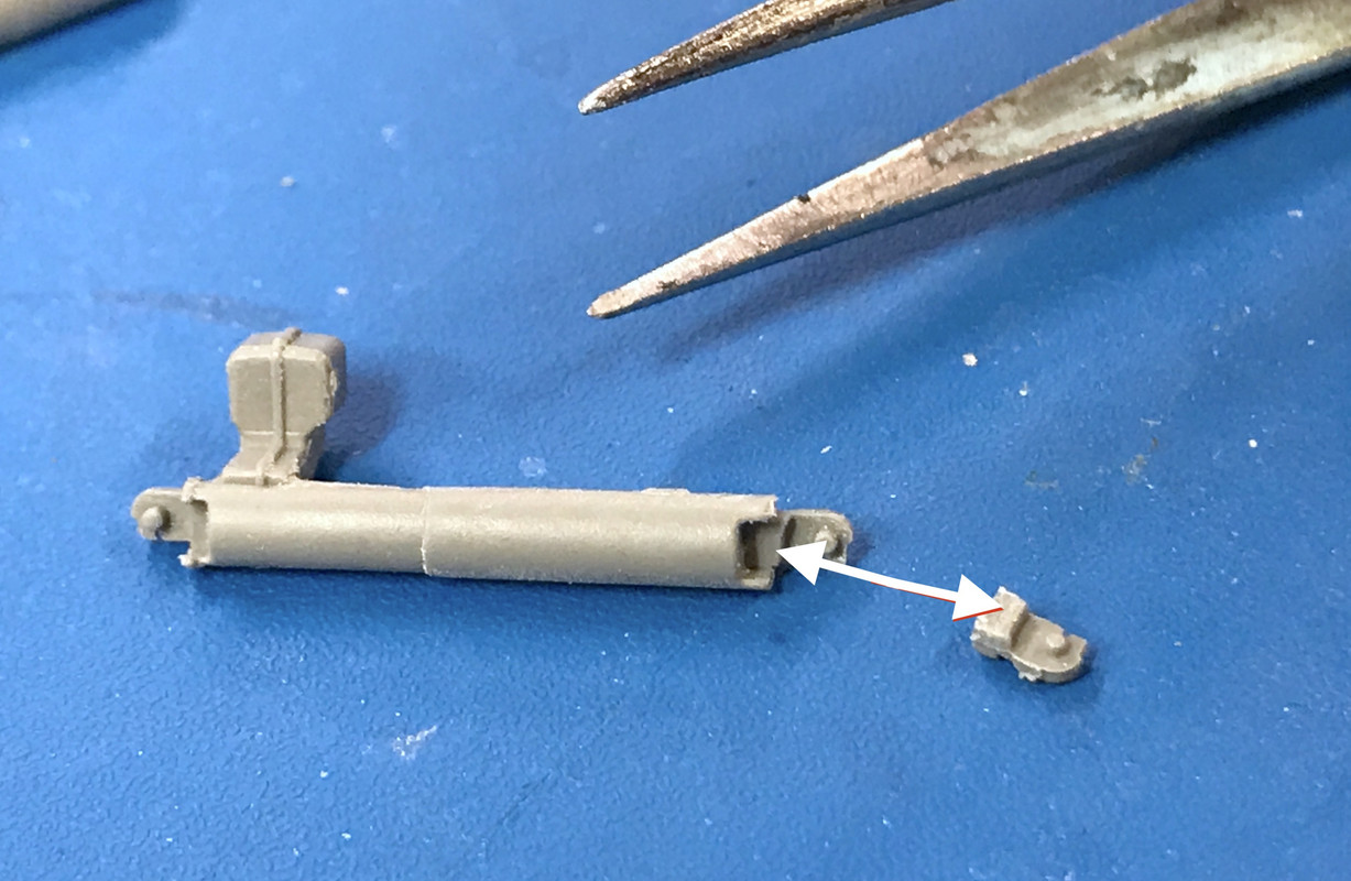

As you probably have surmised, when I set my mind to doing something, it probably gets done. I did get three out of the six bogie shocks built with the kit parts. And I found a way to glue the ends on with more success than I was having.
I placed the tiny end in its slot and then held it in position trapping the suspension arm. I then add added a very small amount of solvent cement to the back of the end and continued holding the tweezers until the glue set. I had to add the glue with my left hand, which for you non-ambidexturous (spelling... this site does not access the MAC spell checker) that was a challenge in itself.
This technique worked well for the three ends that I had left. I was three ends short! That meant Plan B. I had to add a styrene end with phos-bronze rods to replicate the missing ends. This activity took most of the afternoon. It was not easy and it was not linear. The first attempt worked great, which gave me a false sense of accomplishment. The next two took almost an hour and half.
I made a micro-saw cut some distance back from the shock's end and then removed the material down to about half the diameter. I then cut a piece of 1/8" square Evergreen styrene, notched to fit into the cut on the shock. I glued this with solvent cement and let it dry.
The size of stock I was using was obviously oversized, so I used various methods to reduce the size and blend it into the existing shock strut. After shaping, I cut the slot for the existing suspension arm with two strategically spaced razor saw cuts. I then removed the piece between the cuts with the point of a very new #11 blade. The first attempt was perfect, although the slot wasn't quite deep enough and I had to fudge it a bit to get the suspension arm to sit deep enough in the slot. I then drilled the 0.022" hole through the clevis and tied the two parts together with the phos-bronze wire.
Piece of cake... NOT! The second shock decided to rupture in half at the end of the flat cut due to putting too much stress on it when sanding the square styrene to make it round. This was another side trip. I drilled and reinforced the joint with the heavier 0.032" wire. It didn't come out perfectly straight. It will be noticeable.
Then I had one of the clevis ends let go due to being such a small cross section and when manhandling the wire to get it installed. This was not repairable and it meant ripping out the entire piece of styrene and starting over.
The other thing that happened was I cut the slot on the wrong axis not looking at the clevis on the other end. And then the other end clevises started letting go due to all the handling. They didn't break, luckily, but they were troublesome to get back together. To avoid overstressing them, I cut some relief notches in the suspension arm eye's edge to guide the pins so they could snap into positon with less pushing.
Finally, I was able to get all six bogie arms connected with shock absorbers. Their ends are different and a little fatter. If I attempt to reduce their size to the kit parts, the Evergreen styrene would have fallen apart. Evergreen's is a much softer composition and wouldn't hold up.
When painted they won't look too bad. Considering the alternative, meaning three incomplete bogies, I'm okay with the solution.

Thanks! Yes... I suppose it does. Today I really got down to business on making the tracks. First I completely cleaned and reorganized the work area. I had a pile of miscellaneous crap on the left side, and more at the back and on the right as well. It made it hard to find little bits when they launched. I also put up a cardboard wall on the right size as a backstop to "catch" hyper-velocity little parts. I put quotes around "catch" because it's working more like a richochet board that reflects the projectiles to other unknown places. I hear them impact the cardboard, but then it's anybody's guess as to where they actually land.
I noticed in my picture of the lastest interior work that the angular support on the driver's side was no longer there. I didn't realize when it broke. I did find it on the floor. To repair it I reinforced the joint with a piece of 0.032" phos-bronze wire and some CA. The fracture zone was too small to just reglue it. Then all hell broke loose when I was working on the hull to fit that part. The front left bogie came off the tank! The little plastic part that glues to the bogie strut and the bogie then fell apart since this little piece is the key to keep it all together. To make matters worse, one of the pins that serves as the pivot point for the right swing arm was broken off in the swing arm.
It took almost an hour to repair it all. I had to drill and pin the right arm pivot and then drill and pin the retaining plate itself since its glue joint was getting too munged up to be effective. The shock pivot on the left side (one of the kit hinges) kept separating. Each time that happened the volute spring would fall out. This happened over and over. I finally glued the volute to its resting places. This stabilized the assembly. It reduce mobility, but at this point mobility was the least of my worries. I was beginning to doubt if I could get it back together at all. Once it was stable, I could get the pinning done, got it all back together and touch up painted.
Then I got back to the tracks. I've got it down to a more fluid thoughtful process. I found that pre-staging everything made it go much faster. In fact, the fine cleaning of all the little bits took much longer than the assembly.
I found that supporting the sprue that has all the pivot rods kept it more level and made it easier to glue the inner tread pads, although it was holding it a little elevated. I eventurally went back to just letting it lie there while gluing in the first couple of inner tread pads. Once a few were in place, it stabilized. In this image you can see that the pivots are sitting a little proud of the right side tread pads (on the bottom).
I found that staging the inner pads so they all face sideways I was able to grab them in the right spot with the tweezers and get them in position quickly. The amount of liquid cement I'm using is very litte and it evaporates very quickly. If I fumble with the parts, but the time I get them in place there's not enough to hold the part. You have to be quick and precise. Often those two things are mutually exclusive.
Here's the caps lined up ready to glue in place. Remember: the glue can ONLY go on that little ridge with the open divot in it. If it runs down the side of the ridge it will get into the pivots and freeze the tread at that link.
I took another one of the jigs (there are four, one for each of the tread sprues) and removed the end lugs. Those lugs line up the upper part of the jig. This let me use it as an alignment jig for joining the 6-link track segments.
Joining the segments is easy with this method. I ended up fastening the jig to the table with double-sided tape so it wouldn't move around. You have to make sure you're fastening each segment in the proper orientation to the rest of the track.
I've completed 44 links so far. Each track requires 79 links. So I'm halfway to the first track. I think I'll be done the tracks by next Friday. They are getting faster. I did four this afternoon and that included fixing the that pesky bogie. The track is nicely flexible, but it's not very strong. In fact, I really wouldn't want to put any stress on it. I've already had some links break loose when the inner pad glue joint wasn't secure.
