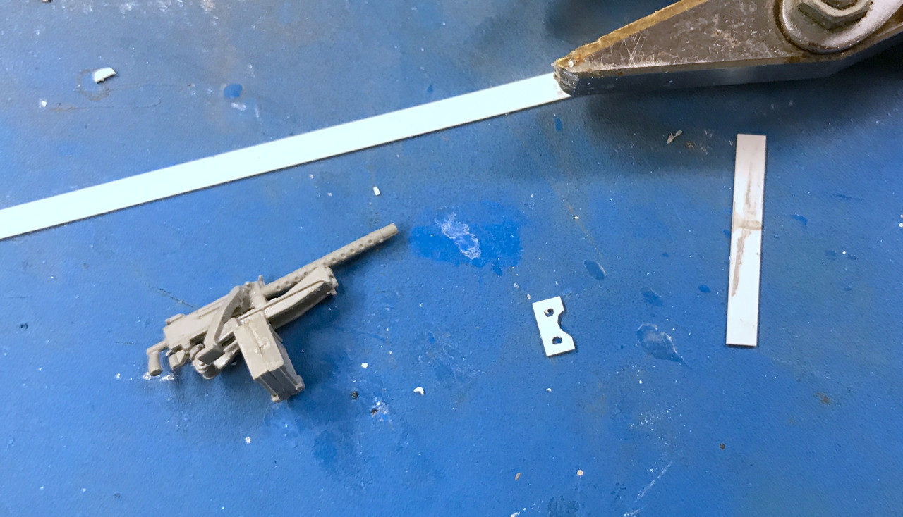

Very limited work time... had to do a ceiling touch up painting job after I went to the hardware store to have a paint chip matched. I got that front support remade for the 30 cal. coax. My first attempt looked like this.
This attempt had some holes to fit over the oval pins on the gun's supports. When I tried it in the space, it tried to push the gun further into the mantlet than it is supposed to go. That piece was 0.015" thick. I substituted another piece what was 0.040". This piece will work, but I had to let it dry overnight so it was a very good, strong joint. It will be stressed a bit. The thicker styrene makes up for the softer consistency of the Evergreen styrene.
I removed the pins and sanded the supports flat so I didn't have to worry about it.
This needs to be painted before assembling it the main gun part. I will be painting the gun assembly tomorrow or Friday.

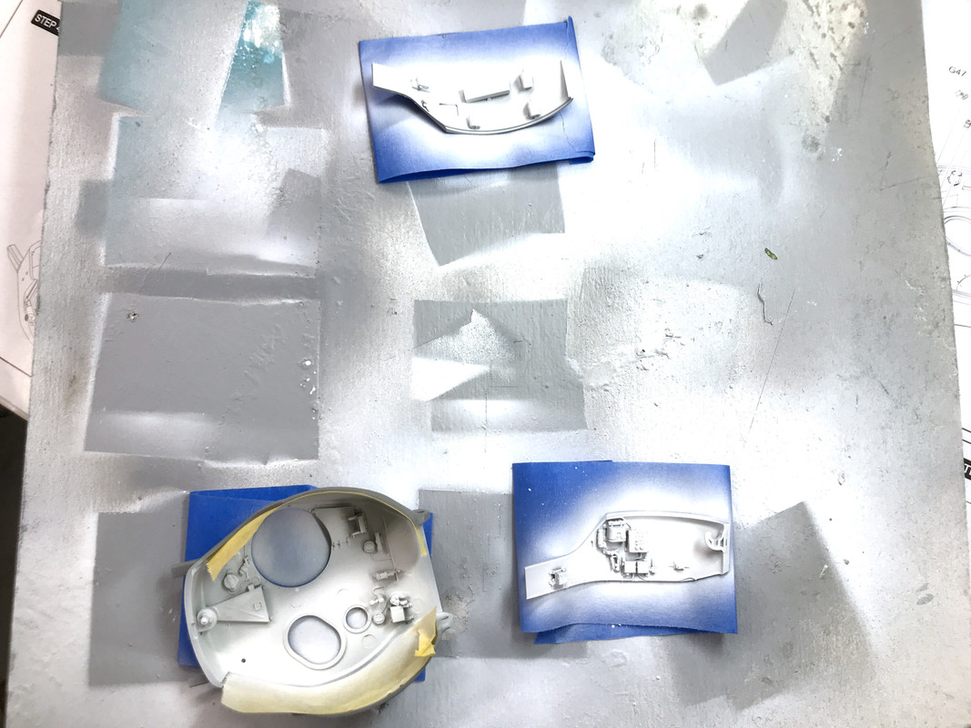

Okay, enough story telling. I got the upper turret painted and assembled and made a big dent in the gun. The gun body has 24 parts itself, not counting the 30 cal coax gun. There is a connecting link that was the elevating linkage, that if you include it, the gun will not elevate. I left it out since I want it to be movable. There are poly caps in the gun trunion to permit rotation so why not take advantage of it.

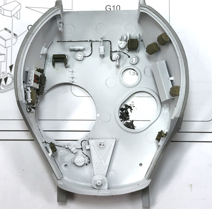

I based painted the white on the upper turret parts before assmbling them. It made detail painting much easier.
I picked out all the little boxes and things. There are three canteens and a binocular box that I paint kahki. The canteen caps are semi-gloss black. I picked out the electrical wiring with better luck than I did on the hull.
I was surpised that the commander's fixed periscope was not a clear part like the driver and asst driver's. I picked out the lenses of the overhead light fixtures with the Molotow Chrome Pen.
I glued the side panels in with tube cement, again since it gives longer working time for large surfaces. I did a lot of back painting on all these little bits so everything came out clean.

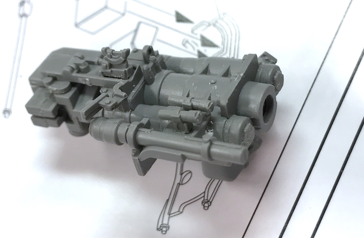

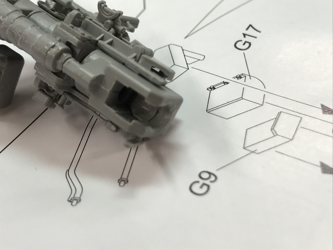

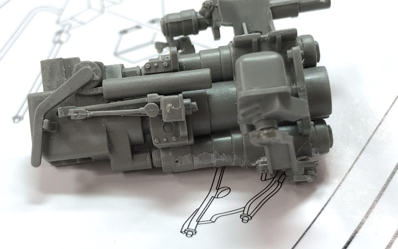

Onto the main gun. This is an enormously complex assembly. Many are delicate and require a lot of location testing to ensure their in the right spot. The recoil mechanism does work! Part G35 is this link I mentioned in the prolog. It connects to that clevis on the roof, but doing so would lock the gun since the rest of the linkage is non-working. I was looking forward to the gun build since I've always had a fascination with artillery pieces.

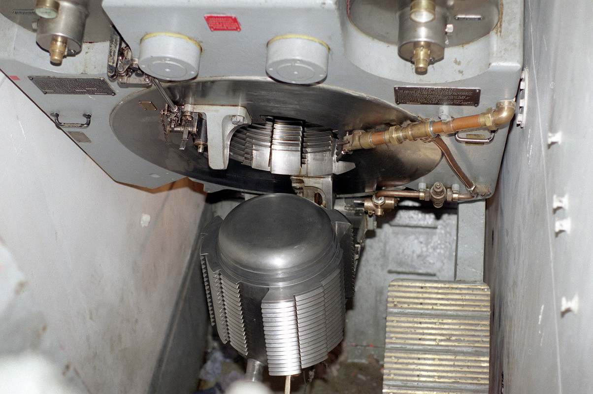

When in Junior High School, the amazing Franklin Institute in Philly had a fully working model of, what looked like, a 5" deck gun from the WW1 era. It even had a step-thread break modeled. WW2 High Angle 5" guns had sliding wedge breach blocks not step thread. That model impressed me so that my friend and I found plans for it in the Institute's library. We had delusions of grandeur. We were going to build it as shop project. Of course we couldn't do it and the project never got out of the planning stage, but my interest remained. Only recently I found just how tricky it is to machine a step-thread breach. It's done on a special lathe that can engage the cutter for the short distances of each thread on each step. It's not something a kid's going to do in a junior high metal shop.
Here's a perfect example of a step-thread breach. This is the center 16" gun of number 2 turret of the USS New Jersey Iowa-Class BB. Very impressive indeed! The threads themselves do not seal against the blast pressure. That the job of the "Mushroom", the bulge in the breach plug center. The threads apply the tremendous pressure to hold the mushroom in place. As an aside (this post is full of asides...) if any of you ever saw Steven Segal's "Under Siege", the guns in that turret weren't real. Each Iowa gun was in its own "room". You can see the walls flanking the breach block. Each compartment is isolated from the other for obvious reasons. In the movie, the gun room was wide open. You can't make good movies in the rear Iowa turrets.
Tank guns are not step-thread breaches. They are sliding block affairs and the breach block iteself is in two parts for the model. If any other model would use one part for something, Ryefield is going to use three. This is the gun top. In the foreground is the optical sighting system. 76W Sherman's had a stabilized gun system and were the only one during the War.
Here's the bottom view.
And here's a view of the breach itself.
The Manlet went on next with its polycaps. The 30 cal coax gun is also built at this point. Again, it's a delicate, very detailed assembly. When I took this picture I hadn't glued on a diminuitive plate that connects the two prongs of the gun's mount to the mantlet cover. I had it in place, went to adjust it and launched it out of the tweezers. This was a high-velocity launch off to the right and I spent 20 minutes looking for it. Ended up making one which I didn't finish by the end of the session. I found a lot of parts (treads) that were lost days ago. They came out of the dimensional rift when this small part entered.
Hopefully, this styrene will be strong enough to do the job. The Ryefield styrene is pretty hard an tough. The Evergreen styrene is not. With all the fine parts I really haven't broken many. I've dropped and searched for many more than I've broken.

I started on the turret. Like the hull, every little tiny bit is there. The left and right inner walls are separate from the turret so they could properly mold the mounting holes on everything.
The reason for the limited progress today was due to not getting started until after 3:00. I was at the LHS (too long... I got the dickens for being indoors with others too long.) I will be glad when the virus is under control, like all of you.
